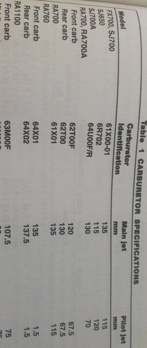

So it's stock jets, and I quoted it earlier, but I guess there is a misprint in the book. Looking at the 64x01 and 64x02.
After talking to some other people it should be fronts 135 main and 105 pilot....rear 137.5 and 105 pilot.
I had a guy who has a similar set up say to start at 140s and go from there, so your saying I need to go down to 125 is that more gas or less gas?

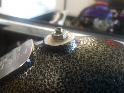

Also I was looking at tuning my b pipe. Currently my bottom is sticking an 1/8 inch out and my top about a 1/4 including the threads under the locking screw. I hear you run these pipes pretty hot....mine has never sizzled water before.
Top is shown. In the attachment.
When factory or people say 1/2 out...does that literally mean a half a turn from closed?
Yes, literally screw all the way in until the screw is bottomed out then turn back half turn it three quarters turn it whatever setting people are describing.
Same thing with the mixture screws on the carburetor, when people say "one turn" they mean they screwed it all the way in and backed it out one turn.
On the pipe obviously you have to loosen the jam but, do the adjustment on the screw, then tighten the jam but while being careful not to turn the screw.
open the top screw of the pipe for better bottom end. theres no set number of turns, its gonna be set based on how you want it setup. the farther open the screws, the more bottom end and cooler the pipe will run, the hotter and less water, the less bottom end, midrange youll have in exchange for more rpms. 3/4 turn open is just a recommended setting. you could end up with more water than that. you can run the ski, open the screw, ride again and keep opening until you feel a noticable powerloss at high rpm, then back the screw in 1/8 turn. im running a 62t engine in a superjet with a c4 chamber and it felt best with the top screw at 1 turn open all others closed.

@TehXshizzit On the b pipe, close top 2 screws and set the bottom one so the beginning of the the chamber (right after the coupler) sizzles just a bit(usually around 1/2-3/4 turn out). This is setting for max power, I’ve seen people start just jacking with the top screw thinking it’s automatically just going to add power. You need to get your base line set first and get the pipe up to temp. Temp is key and if it’s too cold it won’t work much at all. Once you set your temp you can start opening your top screw for better low end response. Open about 1/2-3/4 turn.
reverse jetting just doesnt seem to make a lot of sense. running higher popoff then running a huge pilot jet with a small main jet. ive never had to set one up that way to get it to run right.
adding water to the pipe isnt really adding power, its just changing where the power comes on and is made. the op is saying he doesnt have much bottom end. opening the top screw will help with that. do a degree. but it sounds like he has carb tuning issues to work out first before messing with the pipe. every ski ive had with a factory pipe always ran better at least to me with the top screw open and some middle screw cracked open. when i put a blaster chamber on my x2, i opened the bottom screw 1/2 turn, didnt like the way it ran, then started opening the middle cause that particular headpipe didnt have t handle screws and i couldnt get an allen on the top to open it without removing the headpipe. it didnt have any bottom end either and opening the middle screw didnt help much. going to the t handle screws, i reset them all with just the top open. ended up with 1.5 turns out on top and it runs and accelerates much harder and still has solid top speed. the closer the water injects to the exhaust ports, the more dramatic affect on the power range it will have.
the pipe tuning youre talking about sounds more like for a bouy chaser. if the pipe is too cold then it will have great bottom end but wont rev out entirely. its all about what type of riding youre doing.

there is a thread on here somewhere that goes over how to adjust your bpipe screws and why etc
read factory pipes website they give a great explanation. also depending on what chamber ltd or mod youre running will affect the bottom end. the limited is 1.5 inches longer and will have a little better bottom than the mod chamber.
