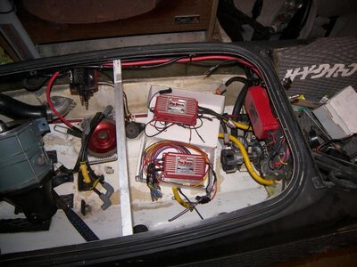

So time is almost up to send this non working msd brain back for inspection and hopefully a brand new one. i had it on the bench and tested it again like 5 more times to make sure it wasn't working. same status as before, pickups work but not the output to the coil. you would think it was stuck in test mode. I talked to E-rok at daytona and i know he cooks his enhancer if it gives him touble. I threw my brain ontop of my gas space heater and cranked it on for 15 min. i picked it up to check it and i had to throw it on the bench it got that hot. I quickly checked the dip switches to make sure they were not melting. i actually flicked #4 test mode and then put it back on the heater and called it a night. 24 hours of frying this sucker and it is working again!!!:icon16: i had to take a pic, this is just msd sweetness here. if i cook my buddies this week and get it going....i am forced to take a new pic.

got another one working. this one died on my buddy steve and he put it in a box with a space heater for 48 hours. it is now got power output to the coils. we haven't got them installed or running yet but i am very hopefull. i think this is pretty cool, i really like TL and my ski is nothing really great without it, but when it does have it in, it rips. seeing all this msd together is pure happiness :jester:
