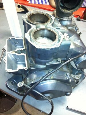

was able to make it home for a day again. I got the engine back together. i had sealed up the case the other day and after bolting it together the crank didn't spin very easily so i wasn't sure what happened. the only thing i could think of was that i didn't put grease on the inside of the crank seals. So i took it apart put some grease on and some more 1211 and it spins now. I don't think the grease was the problem but it works now so i don't really care.

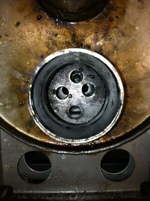

Wasn't able to get the coupler off so i only replaced one seal. i'll obviously leak test it before i put it back in to make sure. What do most people use to block off the intake and exhaust while leak testing? I might lasercut some lexan or plexigass while im at school to block them off.

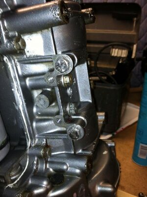

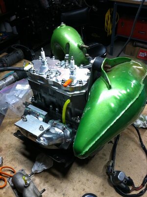

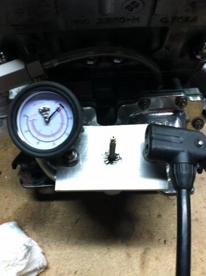

so i got the engine back together late last night. And fab'd up some plate for the exhaust and intake mani that way i could pressure test it, put a needle off an old bike tube on the intake mani plate and jb welded it, then used a bike pump and my pop off pressure gauge. Quickly tested it out and wasn't holding any compression, realized i didn't cover up the drainage holes on the opposite side of the engine. Put the plate on the holes and it still wasn't holding anything so decided to deal with it today. Turns out the plate either wasn't on all the way or the o-ring or done. so i threw a little grease around the rings and it holds compression. Ill probably just jb weld some bolts into the holes so there's no chance of failure. how much compression should it hold and for how long?

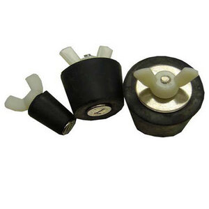

Plug.jpgis what I used for my leak down test. Bought three from a local pool supply shop, cost me $9. Two for my dual 38 manifold, and 1 for my Factory pipe manifold. Then just used the popoff gauge to test the pressure. I did 10 psi for 10 minutes. lost less than .5psi so I was happy.
Thats a good ide, I had the aluminum sitting around anyway. Mine doesn't quite do 10 psi for 10 minutes. I think I did like 8 psi for 1 minute and it dropped 1psi. But I assume a little was leaking through the drain hole. So if that's not good enough than illplug the holes and test again

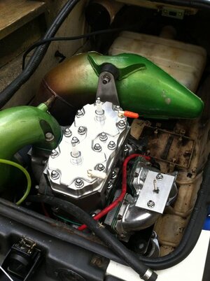

found a vxr pro for $750 w/ trailer which im thinking about picking up to use the pump and engine for a new project. Anyone have an opinion on what would have more power. stock 701 with b pipe or ported 750, 180 psi, msd enhancer, factory pipe, dual carbs, lightened flywheel?
so i have the hull at my house now and have a good chunk of time tomorrow to do some work. I got a start/stop switch from twin and a bilge harness from ocd solutions. I opened up the 750 elec box to figure out how to hook everything up. There's three wires coming out of the box for the temp sensor which i won't be using and don't have, one wire is black/yellow and the other two are red/yellow, should i just cut these wires off inside the box and then seal up the hole in the electric box? I can snap a pic or two if it helps. To better explain it. the bk/y wire comes out of the CDI igniter and goes to the temperature sensor and then there are two r/y wires coming back from the temperature sensor and go to the CDI igniter (the wiring diagram only shows one r/y wire though).
ok, so was sorting through the electric box and trying to figure out which wires are what and i was getting really confused because it looked like i had a lot more wires than what was on the diagram and after counting them up i did... so i had the three extra wires for the temp sensor, im not sure why it is three wires and not 2, maybe one was supposed to go to a fuse? there was a 12th wire coming out of the cdi igniter and i couldn't figure out what it was for. i matched it up with another wire which ran through a 30amp fuse. So i think those two wires were connected to the trim system. what should i be doing with all the extra wires, just cut them and dip them in a plastic?

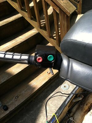

the 750 switch from twin is on (he did a really nice job wiring it, i still need the actual landyard piece that i put around my wrist), it was kind of a pain to get the 650 switch off and the 750 wires through the pole. kawasaki for some reason likes to use phillip head screws in random places, and they never come out. seems like 75% of the steering stuff uses phillip head and a few things by the stator. they also used 8mm bolts to hold what looks like flotation devices in the pole, and those just snapped when i tried to take them out. pics aren't too good, but you can see the pipe fits and the tank from a 300 fits.

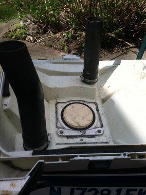

The 300 tank doesn't fit very will with the bottom of the hull so ill probably grab some foam to try and level it out and also need a new tube to run from the tank to the fill spot on the outside of the hull. the hood doesn't fit with the pipe however. the front left tube which ( in the picture the tube on the right) hits dead middle on the pipe. so i still need to deal with that and then figure out what im going to do with my electrics because the box i have is from a zxi which apparently wont work with other 750 stators. ill also have to figure out where to mount that.

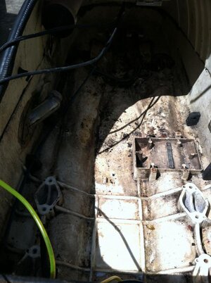

spent a lot of time cleaning the inside of the hull too.

and found these on ebay. says it has a money back guarantee if it breaks for any reason. im ordering two cause they're so cheap, so if the first one breaks really quick ill hook up the second one while i order a better marine switch. also, it will mount to the handle bars pretty easily, where as a toggle switch is a dash mount.

finally finished up all the engine stuff. Plugged the drain holes with bolts. used 5/16-18 bolts and tapped the holes first. Put grease on the end of the tap to grab all the metal flakes then just cleaned it out with q-tips.

finished installing everything and started up pretty quick. will test it out next weekend and hopefully get it dialed in. The water lines were nearly impossible to route, there just wasn't enough room. When i do glass work on this thing in a year or two ill prob redo the water lines and small things like that. I added in quick disconnects and water filters and it just made it nearly impossible to make the bends. I would definitely say for anyone doing a 750 conversion, do not use the 750 limited pipe chamber, just use a normal straight chamber, it made life really difficult.

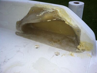

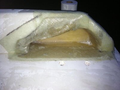

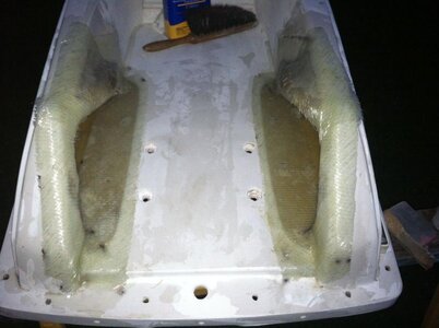

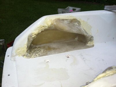

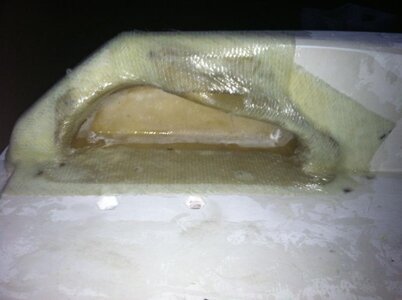

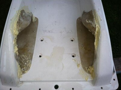

Put some tom21 foot holds in the 650/750 took a bit of grinding to get a decent fit. used ss rivet some 2 part foam and 1708 biaxial to keep everything together. Im going to be doing the turf and a little more glassing to fill in some of the stock holds on the rails and 1 or two others. also switching to a superjet mod chamber so i can hopefully go back to the original gas tank and everything fit better. that 750 chamber was just too huge and needed a lot more work to make everything fit right.
