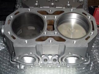

Waiting for the waves, very flat lately.
Maybe some hp with 88mm pistons will help.
