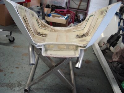

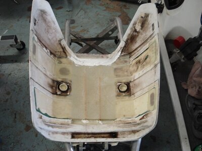

I was working on my own hood molds a while ago but had to put it on the back burner for a while but did realize I needed some kind of hood stops Dave was talking about of the hood would just split if it landed inverted hard. The stops grab the hood and keep it from blowing out each way.

I tried to find a pic of my old 650 SX hood. The X2 only has those 4 little stops. Looks like you cut one off to remove that drain tube. Those suckers are epoxied in there good! But the X2 does have the hinge which helps for support a good bit and it rests on the top of the hull by the steering. Still kind of shocks me that they don't had the full length hood stops like the stand ups do.

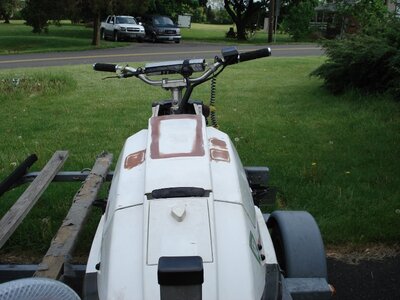

Here are acouple more pic's. Dave I see what you mean bu the hood stops now. I think with the latches I will be ok.
