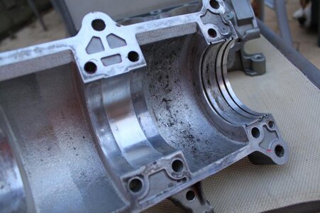

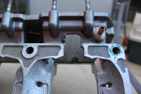

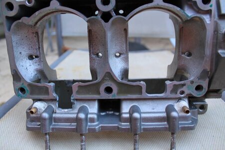

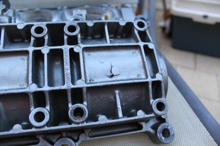

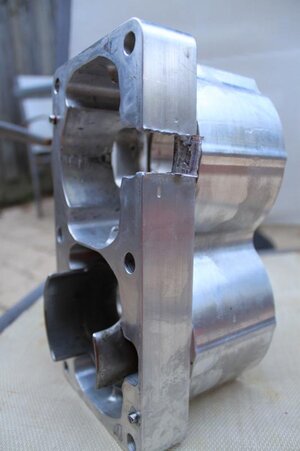

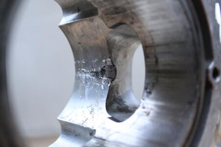

Got my xfs complete 5 weeks ago, had about 60-70 hours on it apparently, ive done about 20 since. Been running it to spec everyday including fogging it after every ride. Yesterday started it up for 5 seconds in the water and sounded like there was water in one of the carbs but before I could cut it, she just stopped. Thought it was just a seized piston till I opened the head and saw a hole in the top of the piston. Been running maxima super m 40:1 and never had a problem, been running like a dream. Can the bullet be welded back up ppossibly? Pretty sure that rod went thru the water jacket at the bottom too, as well as the top of the case, taken a 1/2" chunk from the top of the intake port and most likely the piston sleeve.

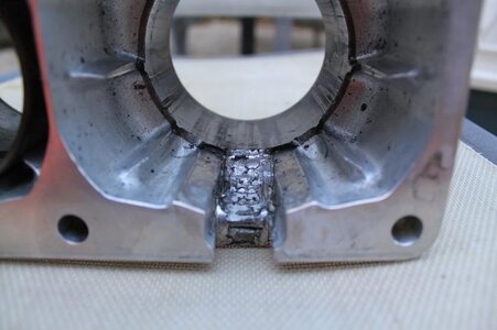

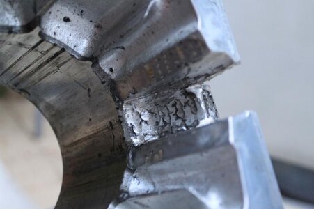

You should be able to get that welded up no issues at all. Just need some machining afterwards. You will have to clean up the ports where the weld / damage has hurt them as well. Might be the right time to put in there bigger bore sleeves they make.
Im not sure of the damage to the cases but you most likely can get them fixed as well

Just had it checked over by my machinist. I can get the cylinder and case welded and get the machining close to nothing. What do the bigger sleeves cost? Would it be a better advantage to put them in? The back sleeve has about 2" left at the top with no damage behind them, so putting a new sleeve in is fine he says. Would I have to port the new sleeve to match the front?

Yes you will need to match port the sleeve/ sleeves
Good news on the welding , sort of a win there. I am sure the new cylinder tat team scream are doing are 900cc, may be best to send a message to chuckie on that.
The advantage of going bigger sleeve is it will clean up any damage after its been welded

That's what I was sort of thinking. Just means an extra sleeve to add to the cost. Wouldn't the bigger sleeves reduce the size of the intake channels?

Yes but then no one seems to worry about that anyway and that why everyone is buying big bores. If people were really concerned about building an engine technically right we would all have strokers with smaller bores to allow for max transfer port volume. The good side about a big bore is you can ring craig and adam and pick up a crank cheap. Quite handy for you at the moment. A stroker is alot more money for a crank

Okay so today i opened her up and degreased her, took her to joe's and he says he can put new sleeves in and bring her back to new!
I took it to a prefessional welder and he'll build it up for me to polish it back to original and joe will deck it and press new sleeves in.
Seeing I need to pay for 2 new piston kits, a new sleeve, dome, crank.. Should I go down the path and fork out more for the extra sleeve to go 900cc? Does closing the ports with bigger sleeves weigh up? Or would it be an advantage to go the bigger sleeves for better port matching with the :):):)d cylinder?
See attatchments below

wax, if i get it weldeded up to new and get the old sleeve pressed out.. MAYBE get a new sleeve in, I'm sure you'd want to make me an offer on the shortblock ;)
..thats my option #2..
Other question is, what do i use to fill the chunck of epoxy in the intake? Depending on the resins, not sure If I have to rip it all out or if it can be added in and smoothed in?
