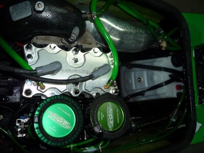

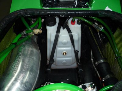

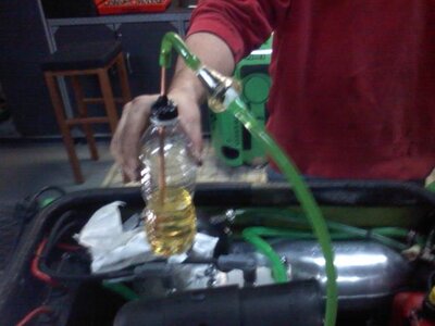

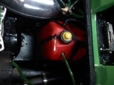

Now have a B pipe in the ski, its travis chamber with andy's head pipe and manifold since I am still looking for one. Dont have much room for a waterbox and i have a temporary 2 gal red fuel can in there. The waterbottle is just what we used to get it running. the sealant on the fuel can was still drying
I attached some cell phone pixs
AND I NEED A B PIPE!!!!!

i was told it was an old school limited chamber. whatever it is it works awesome with his setup, no waterbox. it makes nice power, but now we have to track down an air leak.
