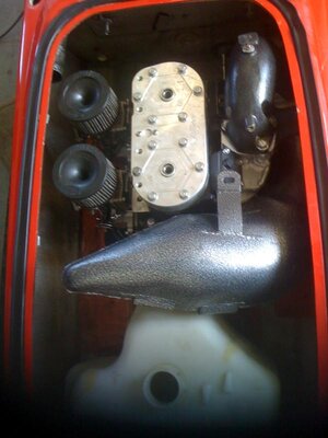

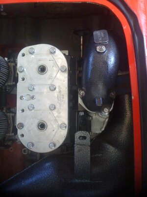

Little more progress, the headpipe actually bolts to the manifold now. Brandon's manifold is not really designed for this headpipe so some material had to be added to get all the bolts to grab. I think Im going to try a 1/2" spacer between the manifold and the cylinder, that way all the stock linkage can be used for the powervalves and it'll pull it off the oem tank some, its just barely touching now. Its going to get tested in the octane hull so just like the sxr theres plenty of room. Also need to make some brackets to hang the chamber, I'll run it through a oem sj waterbox first.
I need a stock servo motor and cables for the pv's if anybody has one.
