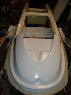

Since you only just touched on the subject and the way the pics move so fast from one stage to the next. I just want to stress for the novice- this is a MASSIVE undertaking. it takes forever to make things smooth and perfect and it has to be to make a good mold.
Very nice work and quality materials. It takes a lot of courage to drop that kind of money on a project like this without the benefit of knowing it will come out right.
If you are not a bodyman- you may want to find one to help you with the final block sanding to make sure its right.
Don't be so sure you won't be making these, there are alot of x-2 junkies who may twist your arm.
keep up the good work.
Thanks Tom! I am actually looking to get some help with the final body work and polishing. I have it pretty damn close, but by no means is it 100%.

Are you planning on using a seat on the hulls you pull from the mold? I was going to suggest reshaping the seat area so it looks better if you were not going to use a seat. I might also raise it ip a few inches if there was no seat.
Also will you be able to pull a part from the mold if that place on the hull where the steering bolts to. I am meaning the part og the hull that sticks out where the tip top of the seat goes. Just curious, I think you are doing a great job!
shawn_NJ
Chasing waves.
Daytona Beach
I'm going to lay 25mm pad down and turf it for a seat. If I had more time I might make some added changes, but I have enough work ahead making it work as is. Not worried about looks (I would not be riding an X2 if I did), just rideability. Also i sanded the top part of the steer tower flush to keep a posititve draft. (where it sticks out on the sides)

Tired of SANDING yet? :ugh2:
Ugh. I think duratec is lieing about "EZ Sanding".....bs! The small detail (read: hand) sanding is killing me. But look what showed up today to make my life alot easier!
