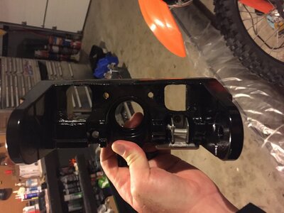

Hand pole bracket is done. Got it sand blasted and grinded out the other side that was pitting away. After that I painted it with black appliance epoxy paint. Ordered the fiberglass stuff from US Composits. Should be here early next week. Sanding down the top hull, hood and hand pole this week end. Also installed my intake grate. Drilled the holes and tapped in the new pump shoe. Got pushed back a little bit. Besides my day job, I still do some watercraft work for a few customers. It’s that time of year in Jersey.6BEECB28-34CE-40C2-93A6-653EE2DD225D.jpegAF62431F-0624-4A1F-87DD-C72B9CA4E8C9.jpeg
