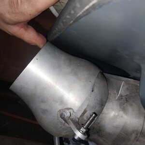

Little problem. Trim hits hull. I'm at about 25deg of trim throw already though. Debating whether or not I take action...

Seems really long for a freestyle hull by today's standards. About 20 degrees is plenty imo.
It's 5 inches longer than the rip on the bottom deck, but I think the tray is quite a bit longer
Sounds like the consensus is 25 deg trim plus upsweep is overkill for trim throw so no grinding!
