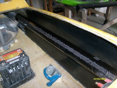

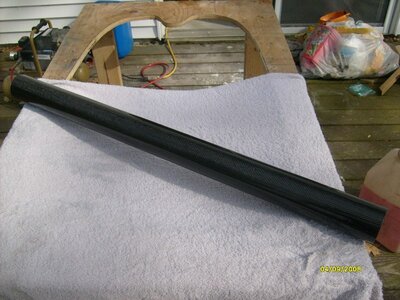

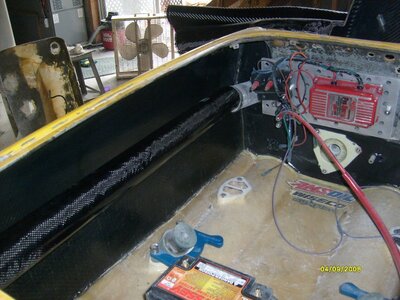

Im sick with some high temps but got some stuff done.Made a carbon fiber
exhaust tube,needs to get trimed down 2 inches and a 90 rubber to the
waterbox.This thing weighs like two empty soda cans and i can stand
on it with no problems 150 pounds.If anyone else is interested in one of these
let me know,I will be makeing more.Im going to be makeing one for my exit
drain as well..and shave some weight.Get rid of the heavy pvc.Iv decided
to make a carbon waterbox,it will be a baffel design and light.

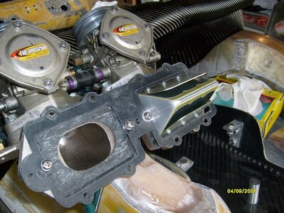

My RAD valves came in, they look nice..should help this LAM with better
air / fuel mix.

Looks nice.
Those Kenney Keepers are installed backwards.
And do yourself a favor and get a good battery. Odyssey is a POS, especially for freestyle. (Doesn't stand up to shock of jumps, rolls, etc)

fyi your kenny keepers are in backwards :rolleyes:
and did u make our buy that tube??
