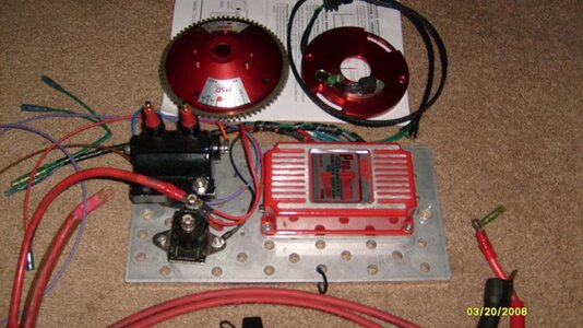

WOW,RiverRat is the man..A++ SELLER.Riverrat hooked me up with this
total loss setup for a awesome price.I expected it to look decent,but not
this good.Everything looks next to new,came with wires and nice mounting plate...teeth on fly look new to.Thanks Riverrat

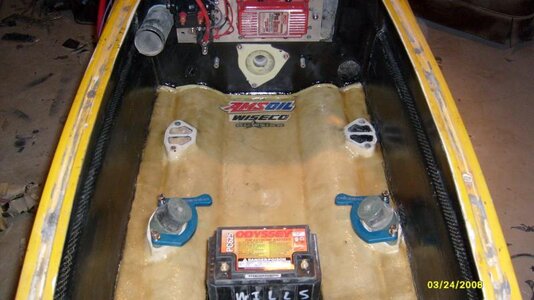

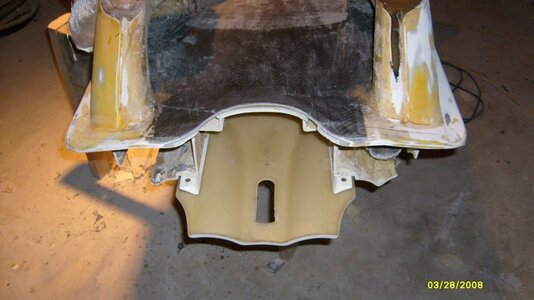

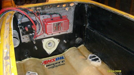

Pulled a all nighter and got a good jump on the inside..took for ever to get
the black por15 off,i like this look better.I weighed all resin and glass i planned
on useing it came to .7 pounds,all of it was used.Legs and tabs were taken off on the firewall, that weighed more than the glass did...so the ski only
saw .4 added weight.Going Carbon B pipe that should knock 1-1.5 pounds off
the b i have now.In the makeing now is a carbon waterbox and i expect to see 2 more pounds gone there.The batt try is carbonfiber molded into the hull
and hooks will be glassed in to hold batt and alum tank down.I mocked the motor in and yes im able to get the fly cover on/off.I shead some weight off
the rear by putting a curvy D (style) cut in my tray..for nozzle throw and ..weight.. .6 pounds there.

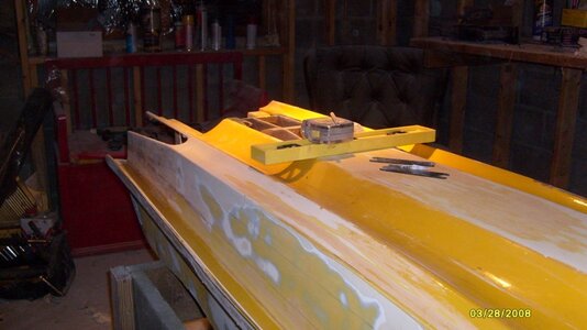

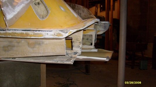

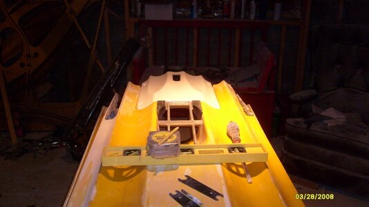

Well,got a little done.I marked out the BUN plate,its getting a chop from th back 3 1/2 inches.I finished the trey cut..for weigh reduction and for
trim.I got the specs on lenzis hull,and finalized one side (cut wise and distance for chime).once back is done,the strakes are going 1/4 in taller.This
will help the ski steer now that its been shorted.The pic of the ski in white is BUNS wich is the same concept im going for.
