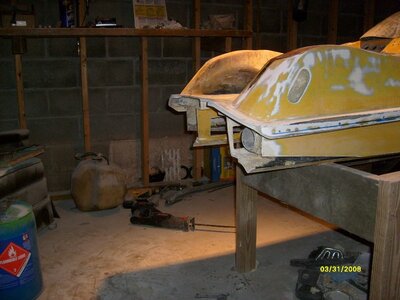

144 12 vein just came in...Thanks Prem1x looks great.more pics tonight more chopping goin on.I wonder if i should move my footholds up a bit,due to the
-2 hull?My heel is in line with the cut i made, not the tray but the lowe hull.

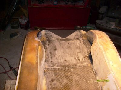

Heres another 1/2 pound,BUN had this cut in his tray at world finals.Going to do some altering on my foot holds,cutting out the blue.And makeing it so my foot can be moved farther forward..and fit into the sides better.Maybe next yr ill change the foot holds all togather.But for now thats the best i can do to get my weight up front if needed. Cutting 1/8 in around the bond line shown in blue,in most spots the glue hasnt made it that far.I should see .3 .4
weight saveings,little here and there adds up.Tomorrow ill sand the corners a little more.
