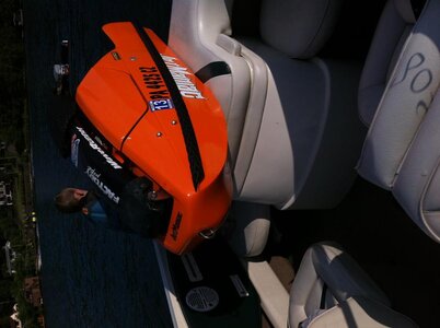

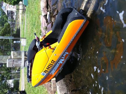

and as luck would have it, we made a nice v wake tonight, just before that my battery died, so I didnt get to try it. Then mid v wake session my boat runs out of gas and the battery quit! Oh well, tomorrow is another day. Here are some more pics, one is of the mobile garage in the middle of the lake.
