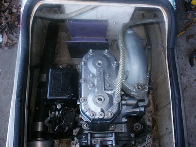

Here are some pics where I mocked up everything today and some pics of the oillite bushings I installed in the handlepole and bracket,also a pic of where I relocated the breather tube on the hood.I have misplaced the center section of the exhaust pipe so it is not in the pics,I did measure off of my 650SX though,the 300 actually has more room for the exhaust than the 650 does,so I can easily install a Westcoast ,Coffman or whatever at a later date.I also had to move the battery box up and over to clear the exhaust pipe and the coupler.

I put three layers of glass on the front of the bulkhead then did three layers on the back.Today I popped the holes in the bulkhead for the bearing housing and bolted it up to the support plate-insert holder. I then glassed in the support plate and mixed up some silica to smooth out some places on the pump tunnel.I am also going to use two 550 couplers on this build so I can move the engine forward another two inches.Excuse the funky bolts holding in the bearing housing,I have replaced them with stainless allen head bolts.:woot:
