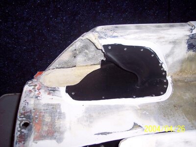

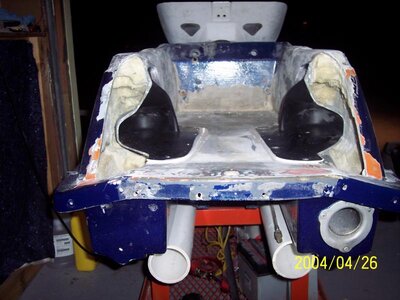

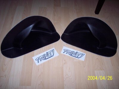

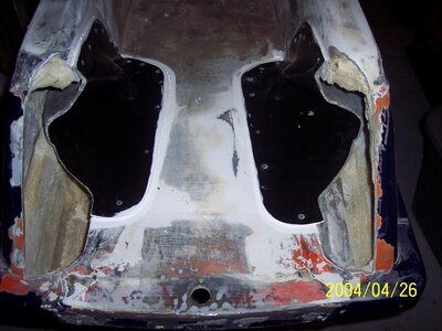

ok I have the footholds installed now i just need foam so i can shape it to make my tray wider in the back. I cut the back off of the trinity holds for a more natural stance. now i am waiting for the glue to dry so i can take some of the rivets out and then lay some glass.i think i may cut the rear lip (bond rail)off of the ski just in case i get a trim system in the future.
what foam should i use????? i found 1lb, 2lb,3,ld.....?

I'm just looking at your ski...Did you not completely defoam the ski? :pokey:
Looks like you defoamed the section near the footholds and left the rest to rot. FYI... I drilledd two holes in the back of my SN and left it to drain for 2 months. When I finally opened it up, the wet foam was spraying me in the face.

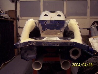

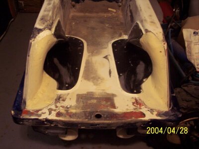

i got the foot holds in and foamed. i started to shape the foam, it is not where i want it to be but i will get it there. so tomorrow to will finish shaping and glass it all in. the tray is 21inches wide at the closest part in the back and 22 inches wide at the very back of the holds. so it is very wide compared to stock.
