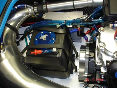

how is the pad held down? glue'd to the hull?
i would do a strap over the chamber for sure!
from one of the waterbox mounts to one of the gas tank mounts.
It's glued down with contact cement.
Once I get the tank, I'm gonna put a strap down

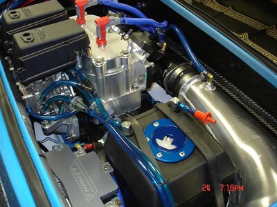

Well. after wondering what the hell was going on with the timing, I found the MSD took a shizzle. I replaced with a the one in my white boat and....Holy crap!!!!!!!!! this thing sounds nasty!:hail:
I pick up some VP c-12 today because the compression was at 240 psi and about .042 squish . As soon as my Jazz tank arrives, off to the water I go!
:brap::brap::brap:

You better be VERY CAREFUL with that kind of compression with the PFP pipe and using a MSD Enhancer!!! Just remember you basically have no timing retard, so don't take it out until you put a timing light on that thing.

Yes, of course! :biggthumpup:

That engine bay looks top notch with the white motor bed. Very clean! :woot:
Thanks Hunter!
I think once the I put that new Jazz tank in there with the custom blue anodized filler neck, it's going to be some serious "jet ski porn":Eyecrazy:

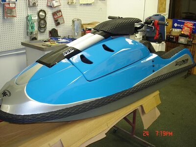

finished!!
:Banane09::Banane09:
Finally completed!! The final piece of the puzzle was the new Jazz gas tank!...thanks Brian!! (thrust innovations)
If the rain stops today, I will be water testing .

What size straps did you use for the tank? Is it two of the "long" tank straps or the short ones?
waterfreak
I had a vision!
Vendor Account
s florida
Yes, those are the two long ones from an SJ. I had to fabricate some custom hook placements to properly position the straps
