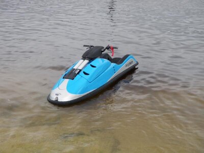

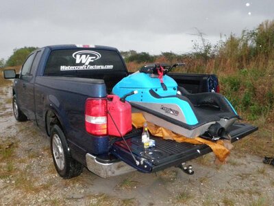

Here are some pictures of the ski sittin high in the water.
