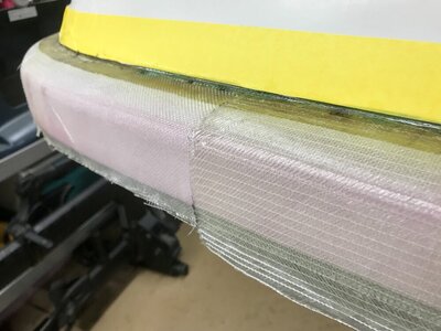

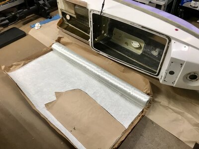

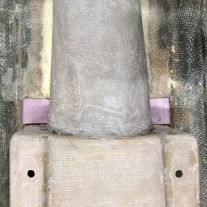

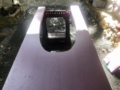

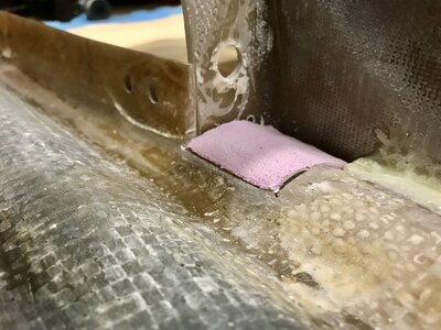

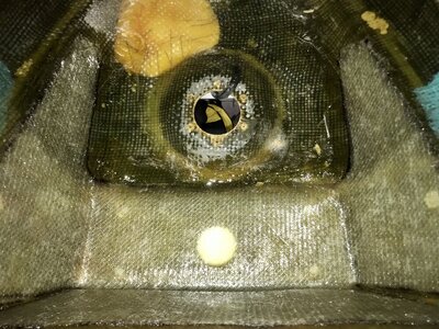

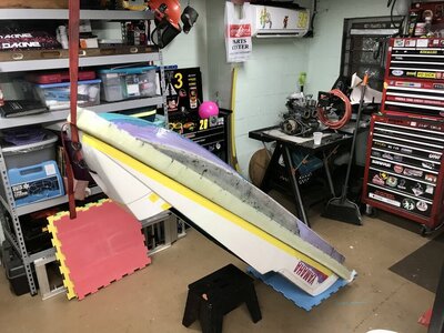

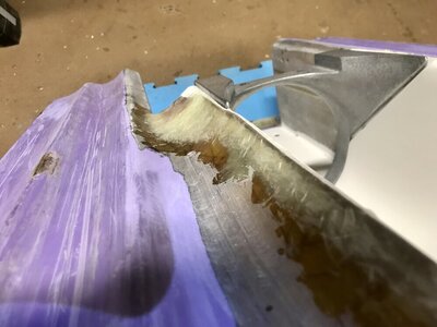

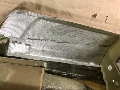

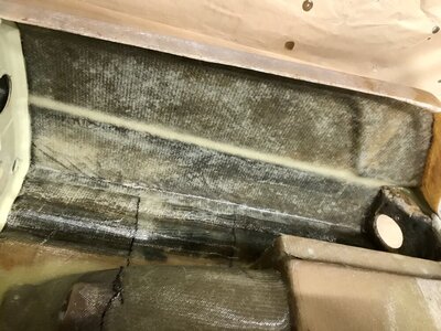

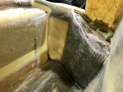

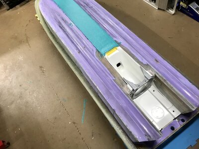

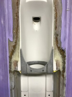

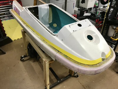

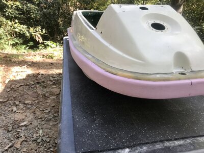

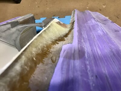

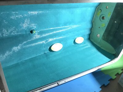

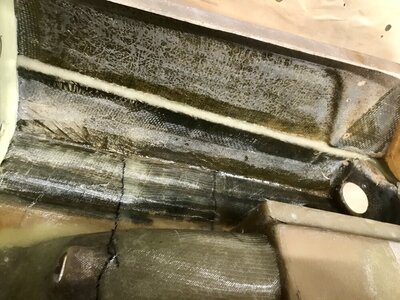

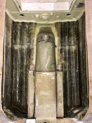

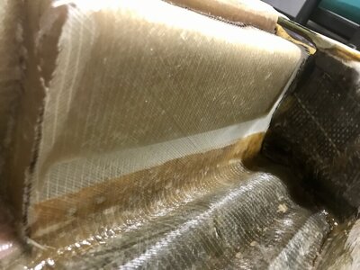

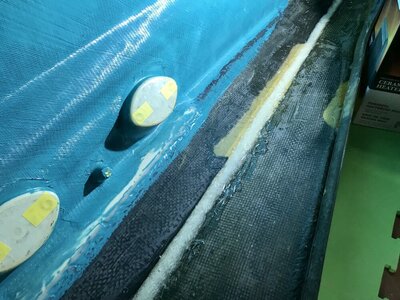

I made some templates for the reinforcement and cut my glass. Before I laid it down, I had to fill the gaps on each side of the tunnel. I used some pink foam and it turned out great!

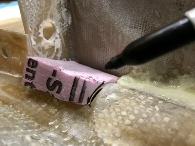

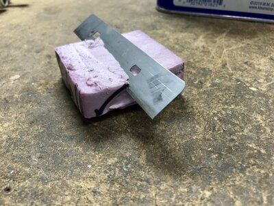

I marked the line with a sharpie
Then cut that sucker with a long razor bla
Juuuuust right.

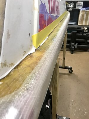

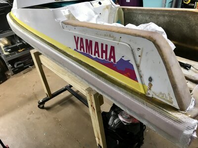

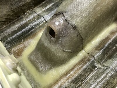

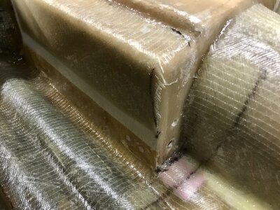

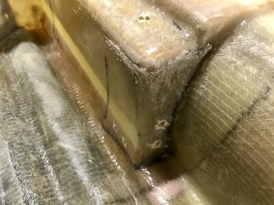

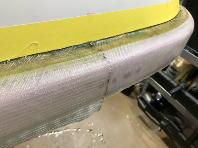

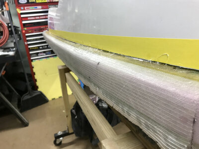

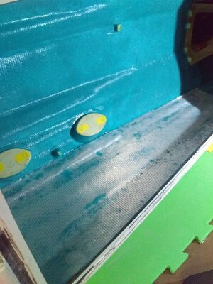

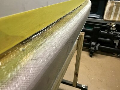

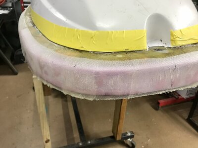

After that it was time to lay some glass! FINALLY. I decided that I was going to reinforce the bottom of the hull, and luckily I was able to kill 2 birds with 1 stone. I made my templates to overlap slightly and did it all at once with 1 layer of 17oz cloth. Took a few hours of smoothing and rolling to get most all the bubbles out but it came out nice!

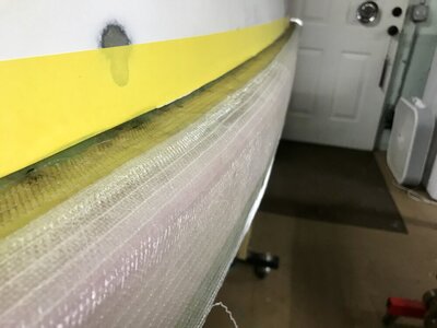

Tomorrow, reinforcing the gunnels! That will be much easier ha.
