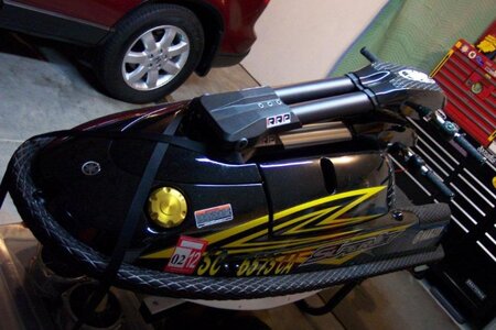

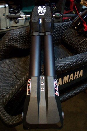

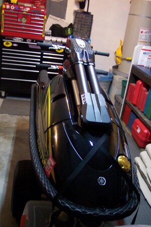

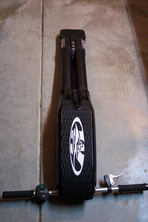

The annodized tubes showed up today and I couldn't be happier. thank you very much Skinnyman!!
what do you guys think?

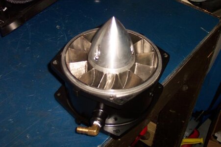

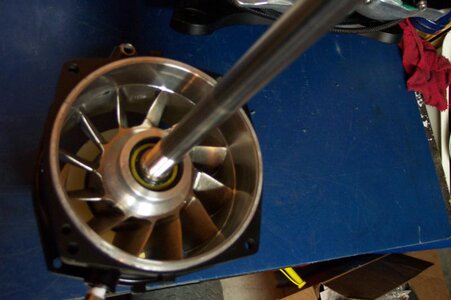

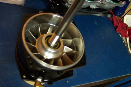

144mm Mag pump showed up last night but suffered a major setback, I spun the prop on to do a quick mock up for shimming and only got 5 threads down before i caught a thread and before I knew it I had galled the threads. I tried all the basics to get the impeller back off but after trashing 2 impeller tools I talked to Dave and we agreed it should be shipped back to him for proper removal and repair of any damage...Not a good start for a brand new pump and shaft but I am so thankful for Daves understanding and reassurance that it all will be made okay.
I feel like such a retard at the moment but let it be a lesson that things can go bad real quick. A dab of antiseize would have likely gone a long way on this. Now after waiting 6 weeks to get my pump, I have to wait another 3 weeks for the pump to get back to Impros for repair. :banghead:

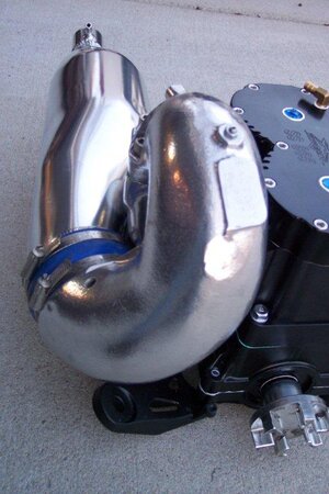

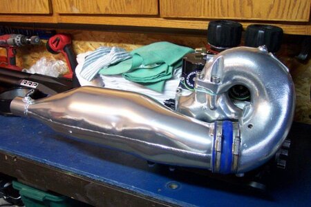

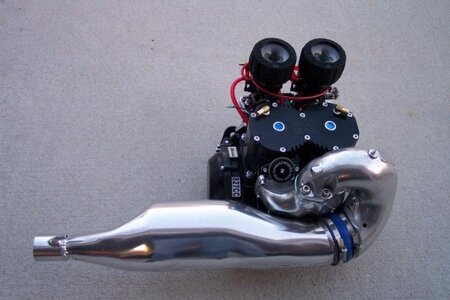

I'm happy again...for now... :biggrin:

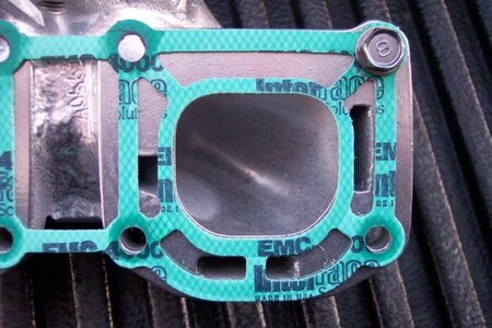

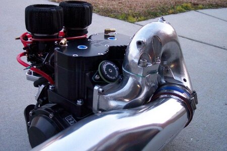

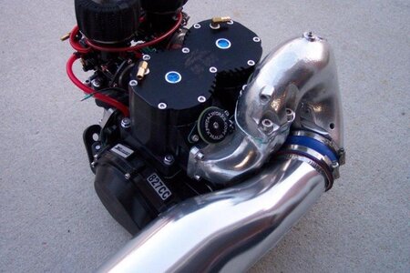

It cost me $175 plus S&H and it was back in my hands in 7 days.
Ceramic Coating was done by Airborne Coatings in Denver North Carolina.
http://www.jetcoat.com/
**Note to self - Fix all blemishes and damage before sending parts to be coated. They do nothing to your pipe before applying the coating. I had a small dent where a stray Tubbie Screw had left it's mark and I now have a ceramic coated exhaust leak as the process opened it up fully. Luckily it is on the underside of the pipe where it won't show and a co worker is going to TIG it up for me this weekend.
