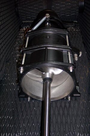

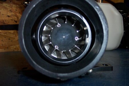

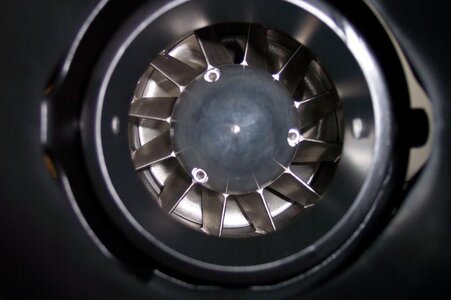

Got my Mag Pump back and fully assembled, I have to give it one more coat of paint to touch up a few spots but it still looks good. You can see the difference between the old impeller and the new setback one by the wear on the wear ring, they say it's a 1" setback but it looks like more than an inch to me.

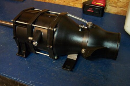

Looking at the before and after on the pump and trim kit sure makes the hour or so standing at the sand blaster cabinet and a rattle can of paint sure seem worth it. LOL

maybe i'm missing something....
that doesn't look like a mag pump (from the outside view).
older generation perhaps?
I sent them a stock Superjet 144mm stator housing and they made it the way they always have. The new Billet housing is only a must when you go over 145mm and the liner gets too thin. You can still get the new Billet housing in a 144 but it's another $175 just for the housing and then you have to send it in to have the wear ring replaced.
From what I have heard, the billet housing was designed for 146-148 pumps so they don't have to sleeve down a 155mm pump and add all the extra weight.

Pump looks real nice boyer, but what's going on with the long pump bolts?
Are those from a couch? They are too long and have nuts on them?
