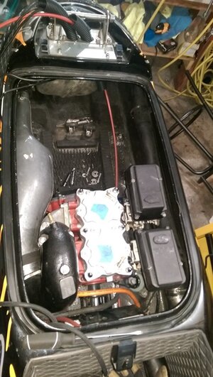

Motor, pump, midshaft mocked. Lookin' good!
WI
Are those couch mounts? If so, did you cut the mounts or the keepers to fit? Nice build btw.
Yes, couch mounts. They've survived countless lawn darts into the sand when they were in the SN. No cracks or breaks that I could find. No shaving or shims. Lines right up. Didn't modify anything for the keepers. Just need longer bolts.

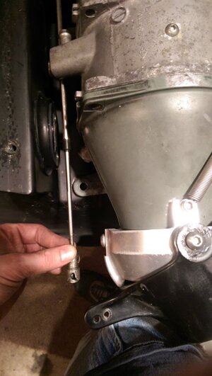

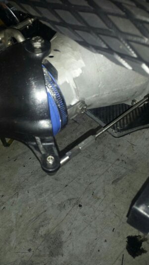

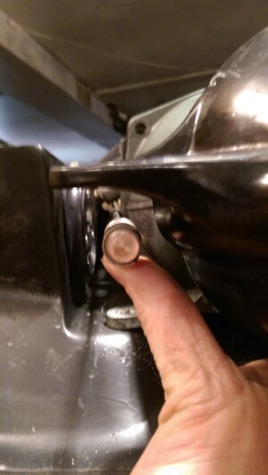

Need some help guys... having some problems with this pump that Im not sure how to overcome. First - it seems like the steering arm does not/will not extend long enough to allow the nozzle enough throw to the port side. Even after I've backed the ball attachment all the way out. Second - the cooling line boss is deflecting the linkage arm pretty far upward and doesn't allow a straight connection to the ball on the nozzle. Is grinding the hell out of it the only way? Looks like I'd have to take off quite a bit... Any advice???
Byeai
"Cheetos-Man"
Melbourne FL
U need a adapter xscream sells it or jetmaniac normal superjets dont have trim so the cable isnt long enough i can get u a picture of my pump in my kdx

This is the thrust piece i had laying around i used
