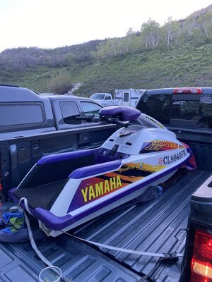

Was looking to get a starting point. Acquired this 760 that wasn't running. Got it running and now trying to fine tune

When you say stock everything, do you mean this is a stock motor in a stock ski (something that came stock with a 760)? If so, why not run stock jetting?
If you have this in some halfway normal stand up setup with dual carbs you're probably WAY rich on your high speed. You'll probably end up in the neighborhood of 120 or 110 on the high speed jet. What you have in there right now is in the ballpark of what people run with a single carb.
Na it's not a stand up. I know this is really a stand up thread, but it's the only thing I could with people posting their settings. It's actually a waveblaster 2 760 with everything stock. I tried using everything stock in the carb but couldn't get it to start or halfway run. I read were someone suggested the jets I'm using and needle and seat and spring and it actually started and after 3 months of rebuilding the carbs, rebuilding the top end, and starter bendix, these jets and spring allowed me to ride it. It's the best I have ever seen it since I've had it. I have been thinking of going to back to stock jets and leaving the 2.0 needle and seat and 80 spring and seeing how that goes
I mean....I know it's probably not what you want to hear, but I'm pretty sure when Yamaha sold it from the dealership brand new and completely stock it started and ran. If it doesn't start and run with everything stock something is wrong.
I'm sure it did lol. Tomorrow Ill go back to the factory jets and see how it runs
Put the factory jets back in, a m the trailer at home it sounded great. In the water it was horrible. At one point, I had it wot and going about 7 mile an hour. Sounding like an exhaust leak now.
I just bought her.. I was told she was jetted for 5k ASL and I ride at 8k asl.. I was hoping that the ski wasn’t going to be that far off jetting wise but she is .. I do understand I am loosing 24% of power just riding that high up but still need help.. any suggestions for jetting?
