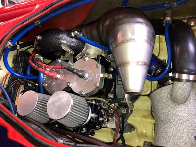

I ended up with this..
115P
132.5M
1.5n/s 80g-38#
LS-2.5
HS-1/2.
1996 Blaster
62t case, 760 cyl, Wiseco crank, Wiseco piston,Triton head,MSD enhancer, Carbon Tech reeds,760 oem 44’s, Riva filter pods,B-head pipe opened up too 48mm,TNT chamber, Coffman WB, Flow control valve, Solas, Carbon ride plate, Work intake,pro-tek trim nozzle.
