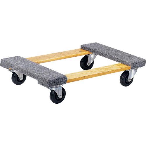

yeah my everyday shop dollies are made of 4 x 4's and a 2 x 6 to hold the wheels. i did it like a shopping cart, two that are fixed, two that swivel.
the small dolly I had laying around and needed something to set a ski on while I was swapping skis to the trailer and I did it temporarily and it works pretty good.
especially considering how much it cost in hardware and carpet( I used floor mats from home depot- cut up), wood and wheels and then the dollies are like 25 bucks.

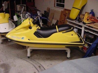

I made a pvc version pictured below for $37. I later added 6" wheels. It lasted only 2 months then I heard a noise in the garage. Called and ordered a Big-Foot next morning and I'm not looking back. So todays lesson boys and girls is, PVC is for sprinklers :tomato:

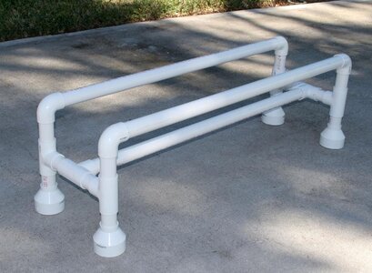

Ok Fellas, I see some of yall have jumped on this bashing ban-wagon. I'm the one selling these stands and I've had to argue with this "Wayne" for a couple days. First over my inflated prices (his words) and 2nd over stregnth... 1st things first. If you can build this stand for $40 the there is NO WAY you are using the same materials. Wayne bashed me over and over on this point then I finaly had to shut him down by waisting my time going into Home Depot (where he said he got his prices) and get actual cost on materials..
$3.61 Elbows X4
$2.96 3 way X4
$3.24 Clean out X4
$1.69 Cap X4
$3.97 Casters (225lb ea.) X4
$10.58 10' pipe
$5.48 glue/primer pack
$84.37 out the door!
Now, it takes about 1.25hrs to build it correctly, every joint perfect, cuts right. etc. and I use a chop saw to make sure my cuts are 90's and the pipe will slide in flush against the stops and not weaken the joint.. squared up correctly also, casters drilled in etc. from pulling the tools out, to puting them away..
ok, add 15 min to drive to HD. Buy parts check out. etc another 15min. Drive home unload etc 15min... so lets say another 45 min..
So lets say I have 2 total hours of my time, and $85 into 1 stand.. I make $55/hour ASSUMING I have someone standing in front of me waiting to hand the cash over and take it home. Not, me having to wait for people that want to come over, or me delivering it anywhere from 10-50 miles for free, nor anyone coming over to kick tires.... What is your time worth????
Wayne also was sure to change subject matter on me also when I showed him what it really costs to build a quality stand. and said it WILL FAIL and break, although He hasn't seen my other designs for heavier skis (800lbs and up) yet he says they will break because of the picture above. If you notice that stand used thin-wall or sewer fittings. the 3 way clean-out he used is so thin you can see thru it.....THIS IS HOW A $40 stand is made! NOT what I do... I deal in skis and it's mostly referal/repeat customers, do you think i'd sell an inferior stand so I have to replace a ski??? no...
The smaller stands in the pics are mainly for smaller 2-3 seaters. My test subject back in the spring was a 2005 Seadoo GTI 3 seater and ME on top..
Im not selling a Design, Im selling an actual product that's been well built and tested. If you feel the need to keep bashing me so-be-it. But I think I've justified my prices. (also keep in mind the bigger stands cost MORE to make but I don't charge more). If you have any questions ASK before you BASH!
