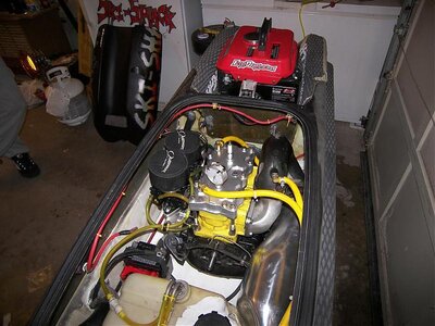

It was too cold to work today so after some breakfast and a short road trip to Art's tools, Me and Steve found ourselves in the garage glassing and tinkering. I picked up a little 1.5hp 2 stroke generator that i can use to power my digital smart charger at the dock. i have a little 5lb battery in my ski and am going to try it with a MSD total loss. not too sure it will work for long but i will give it a try and let ya know. :fingersx: if it lasts as long as the fuel in my tank i would be happy to charge it while filling up the tank and having a smoke break. not sure it will work out that way so i will make up a different battery tray for my normal battery. I can swap it in if i ride out in the lake for the day or just run the little guy for a quick evening 1 tank session.:loser:
So today while steve was fiberglassing stuff i went ahead and finished up my battery connectors, bilge wires and kinda stood around looking good. i guess i should have layed up a rideplate or something but i didn't want to take away from standing around, lookin good.:439:

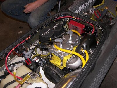

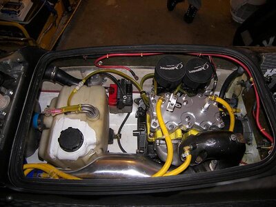

I got a msd total loss from a fellow board member and had him send it to JSS for a makeover. i have it installed and wired so i can flip some switches easily. once i am sure of everything i can clean up the wires a bit more. John made it real easy to install and sent along lots of extra connectors for any small changes i needed to make. I set the timing and a curve i think will work. It fired up right away with some gas down the carbs.:Banane36: Steve brought over his digital scale for cross balancing race cars and it weighed in at 273 lbs with my small battery and 283 lbs with my normal battery. That is with a stock rideplate and a full roll of fuel line in the tray that i have to install yet. Pretty happy with my ski and am really looking forward to riding it. Not too much left to do except finish the rideplate, fuel lines and add some premix!!! i think. :icon16:
