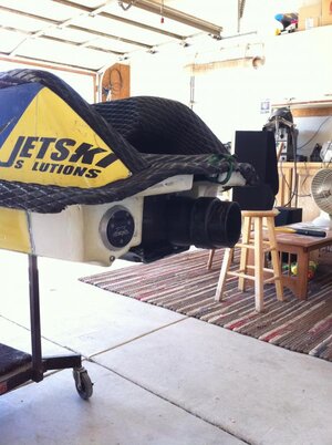

well i found a better pic the the rear of the xfs with the pump and it looks like i need to shorten the bottom a bit more for the proper effect. i think i have the tail end of the tray area worked out in my mind but it may change as i build it back together. i hope to have the ends of the hull squared off side to side and up and down. tommorrow i will have a better idea and pics.

I kept mine square up and down, so I can keep ex and scupper simple. But am thinking of taking more off now. (thanks dude) After I cut the tray out, I'll see how much I have to work with. I want the shorter length for obvious reasons, but am curious how recoveries will be. From stabs, or any 180 tricks. All mods have good and bad points though. But there's a few trade offs I am more than willing to lose to gain a few other more fun tricks.
Here's where I am at now, but am having thoughts of changing it after seeing your pics and also considering how it rode with my weight, pole length, foothold position blablabla... It makes sense for me to shorten more. I think haha!

hey jay, is that an abs extension on your turn noz? thats great, hows it work? i was looking for a 550 one to put on my ski but didn't find one, so i was thinking of doing a carbon extension. I shortend my sn hull and this hull the typical way before, but your right this is extreme. whose idea was this anyways. i blame rick roy and his xfs. Anyways, i recut the bottom deck proper and squared everything up pretty good. I built some forms to do my initial layup. i will find out tommorrow how it turned out. i also sanded my carbon wrapped pole and went up to 2000, when it is wet, it looks good but after i clean and dry it, it turns dullish. i am thinking i need to buff it to get it to shine like when its wet?
