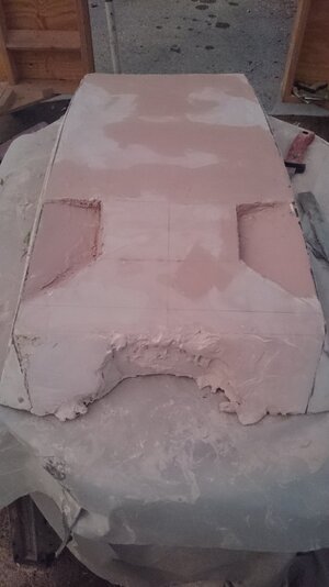

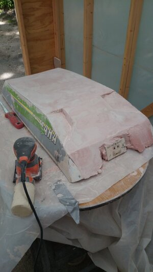

Been busy washing then painting the whole house and garage. Found some time the last few days to make some progress on the hood.
I don't think I've ever seen the type of venting and drainage system I have planned before. Should eliminate the problems I had with the breather tubes I had installed on the stock hood. Front of the hood is narrowed by 1/2" to match the top deck profile and back of hood is widened by 1/2". I kept the side panels of the original squarenose hood to help the transition from the hard lined nose to the rounder profile of the sides of the top deck.

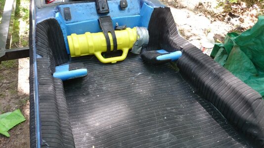

Yeah I think I'm going to try making a low profile boxier handlepole. Straight instead of curved and a little thinner on the depth than my current one is. It definitely won't be thick enough for breather tubes but should be fine for the cables and wires. It'll have to be carbon since it will be thinner and more prone to twisting. Getting creative with some hybrid fabrics might have some merit but I'd have to experiment with that.
That'll come after I make some adjustable footholds. Lifter wedges are nice for versatility but not much else.
Edit: Made footholds today while a layer of bondo cured. I guess pole is the next thing on the list after the hood then.
Wisconsin
Yeah I'm looking forward to seeing how well they work. They're large enough with the padding removed from under them to fit my feet almost to my ankles. My gunwales are thin and very low so they didn't leave me with many options for holds.
They look pretty far forward but that's where the padding was depressed from standing there the most. Still not sure if they should be further back though.
