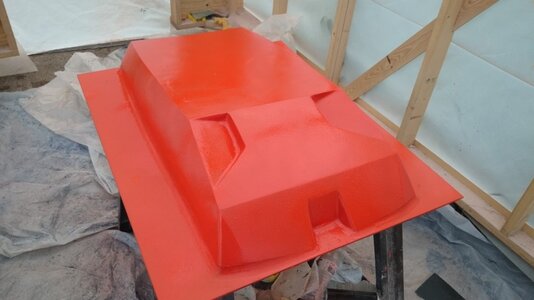

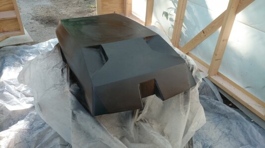

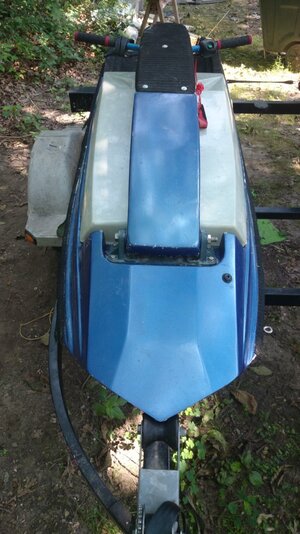

Needs wet sanding, more coats of paint and some blemish touch ups. I'm not going crazy with a polyester or epoxy primer with this plug since I just want to get back on the water at this point.
I like it. I definitely think you should go with a tube style pole. IMO if the pole sits above the lines, it looks best when it contrasts. Flat hood, round handle pole.
How are you going to create the hood liner plug?

Right now I'm thinking I'll make a male liner plug inside the finished hood shell. That'll be the easiest way and will let me test fit it on the ski to be sure it clears everything.

No (little) flange around the front? Is there a gap between the bottom and the hood in the bottom left corner or it just the lighting?
Wisconsin
Yeah this was the biggest mirror I had laying around besides a couple ping pong table sized ones. I plan on extending the flange after the rest of the mold is done.
The hood angles down towards the center and lifts it off the mirror which is what I think you are seeing. The perimeter of the hood is joined to the mirror with plasticine clay so there are no gaps.

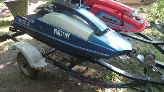

image.jpg I see so much work put into square nose hoods these days. I did this three years ago and it's still working great. Cut the bottom 6 inches off the stock hood flipped it over on a piece of glass and laid up inside of that. Two vent tubes glassed on the inside sucking from the back
Wisconsin
Nice! That's definitely the simplest SN hood mod I've seen. I went all the way with mine, shaping a plug and creating a mold, because I'm going to be using the mold to create another foam plug to use for the hood for revision two of the prototype. It's no longer a SN hood at all. Every dimension is different. The curve on the side panels is changed and nothing else was kept from the SN hood.
