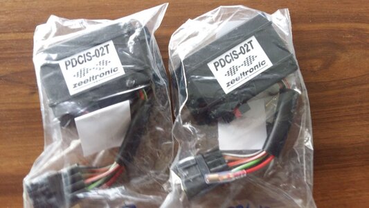

just installed one but with the rectifier plugged in i get no spark - when rectifier disconnected - all ok - i get blue spark - red from rectifier is connected on same red main connectors as cdi - that is main red from batt
Will a flywheel from an 1100 work on the 701 (760 cover and stator with Zeeltronic ignition)? IE, the crank taper is the same? I realize that it will only have one bump for the ignition pickup, but it looks like we could account for that in the Zeeltronic software. Plus if this flywheel is used you wouldn't have to grind the little bump off (760 flywheel) and possibly change the balance of the flywheel. I guess it could depend on where the bump is in relation to pickup and TDC (if the static angle is to great)?
waxhead
wannabe backflipper
gold coast
The answer is a clear NO. it needs two lumps 180 degrees apart.
You can use a zeeltronic with the 1100 ignition no problem. Its a different model zeel but it works well
