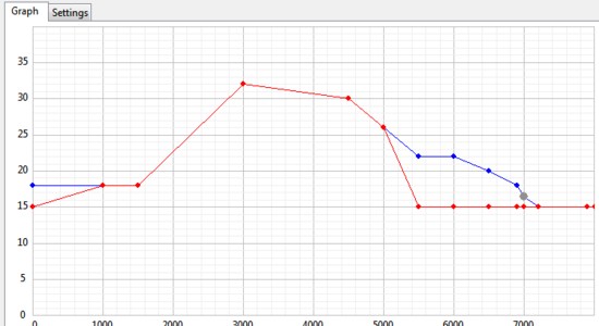

After seeing the stock 760 curve I adjusted the tail end of the wax curve up from 15 to 22. I will post back if my engine blows up.
170psi 62t/61x 760cc
Red is the Wax and Blue is the changes I made. You can fill the outside of a barn with what I don't know so feel free to criticize.
I have a similar situation with the outside of the barn, but I think that low advance at high rpms is both beneficial for power and avoiding detonation at high rpm, the low advance gets heat into the pipe, oem ignition uses a lot of advance because the pipe is not as effective at high rpm, and compression is relatively low.
I think....but I don't know.

I've heard similar. When I was running an hpe 5mil and the tnt v3, holeshot recommended I try lowering the top end of the curve to help with combos, not raising it
waxhead
wannabe backflipper
gold coast
Let me explain it. By retarding the ignition your put more heat into the pipe and this makes it run hotter. think about factory pipe playing with water injection. The hotter the pipe the faster the wave and this means it works for a high rpm. Its like vetec for two strokes
The wax curve you have plotted doesn’t look right. It should only drop to 18 degrees at 6000 rpm I thought, not 15.
Looking at OCD plot on previous page it shows 18. But I am pretty sure mine was at 15. I didn't save it prior to changing it so cannot confirm.
