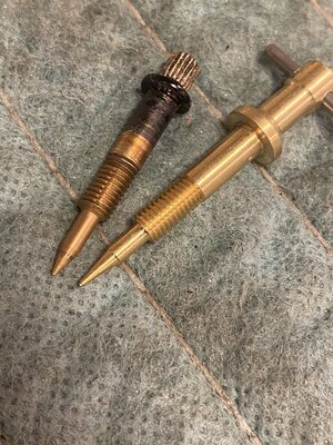

I am pretty certain that my woodruff key has sheared. When I first installed this setup it sounded AMAZING even out of water. I have tried multiple jetting / pop off combo. 4 sets of plugs. Ever since I did the first test ride on the water this past Monday it has sounded WAY different. Almost like the timing is off now. Wont even idle - stumbles like crazy. Going to pull flywheel today after work and see what’s going on. Wax I will download your V3 curve and install on my ZEEL. Thankyou for the link! As for my H/L speed adjusters on carb I installed jetworks EZ adjusters and removed the stock ones you need flathead to adjust. The jetworks adjusters were VERY slightly different shape at the tip. I am going to post a picture of the stock high speed adjuster next to the jetworks EZ adjuster. You guys lmk if it is ok to run. I think it is okay - just a little bit different of shape at tip.

I put the carb settings to 130L/110H 2.0 N&S 95G spring low speed 1 1/2 high speed 1 1/4. I also realize those adjusters I posted that I installed are not the correct ones I pulled carbs off again and installed original adjusters for the time being.
