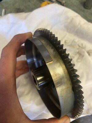

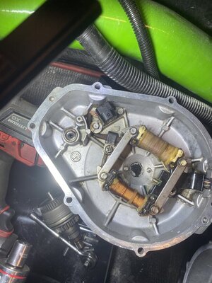

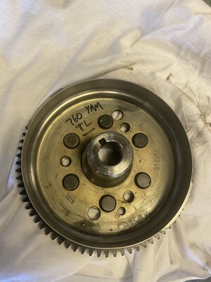

So I verified keyway was still in tact - everything with flywheel looked exactly how I put it. Stator & pickup have no rub marks / broken cables. While I had the motor apart I threw on the stock milled 760 head I have and compression is now 165,165. Pulled carbs again to verify reeds in tact - they still look like they are brand new (vforce 3 reeds) made sure settings were 1 1/2 in low speed & 1 1/4 on high speed. Put everything back together MINUS THE HOOD. And test fired. Once again she came alive and sounds amazing OUT of the water.

Here are pics of my flywheel / keyway / stator - all looked perfect. I will open up my ebox this week and get picture when I download and swap out for waxes V3 curve. It’s the wires that would normally plug into the cluster that I’m referring too.^^ I believe 4 pin - (pink, green, red , black)
