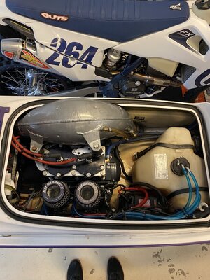

Super stoked for the break in tomorrow, getting my wife’s 550sx and two place trailer so I don’t have to unload/load out of the back of the truck anymore.

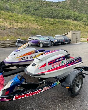

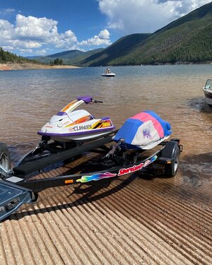

A very up and down day… I did my heat cycles on the trailer, checked inside the motor bay for leaks or lose clamps.. We were good to go. Definitely a different ski, even at 7800 ft above sea level she rips dang good. Put the ski back on the trailer at the ramp to check plugs.. tried to start the ski to nudge it a little more on the trailer and nothing..The start/stop switch must have failed or I think it did. The fuse was good, I could run the bilge pump and even took apart the start/stop switch apart.. nodda
Pretty bummed but this is the 2 stroke jet ski game and will get a new switch coming. I have to take apart the e box to install the new adjustable CDI so a good time to change it out. So I am going to overnight or fastest ship from @JetManiac a new start/stop internals.
I just had the same exact symptoms. Drove the ski onto the trailer. Pulled the trailer out of the water tried to start it to flush the water out of the water box. Nothing. No crank no start.
I also assumed it was the on/off switch. It was the starter relay. I had one from another engine whch I swapped it in. And my wife has been riding it this last month no problems.
Ask Chris at @JetManiac (fast) if he has gotten more in. Or @john zigler at Watcon (fast). Otherwise buy a new starter relay from Partzilla (much slower).
Don't be disappointed. This is still a great sport. But it sucks when your ski doesn't run or doesn't run good. It will be ok.
Now I have to go pull the carb on the FX-1 and see if the reason I had a bog today was that little fuel screen in the carb...
use a voltmeter to ohm out the switch..
First off I am newb.. Only reason this ski is back together is help from a very good jet ski mechanic.
Well I got the ski fired up after I overnighted the s/s/s and relay.. dang it.. They will be needed sooner that later.. Its my wiring, I was moving all the wires and making sure everything looked good, hit the starter button and she fired right up..
I am a terrible mechanic (only way you get better is to turn wrenches more), I don't own a voltmeter ( buying one) and have been using a buddies well equipped garage. So loading her up and will go through the wiring. thank you all very much for the help.

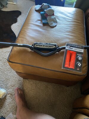

I just got riva bars but I believe they are same as stock, I haven’t checked yet but are they wider than stock?.. What suggestions do you have for the steering system? Quick turn?

I like the over pivot steering myself. Gets the max steering throw and you're no longer swinging when you steer since the bars are directly over the pivot point. And it gets you more forward in the tray for more aggressive riding position. Shortening the pole will help as well. But it depends on what type of riding you're doing as well.
If you are using the 7/8" style bars the Cold Fusion turnplate is one of the best values in a steering system.
It uses the stock bushings and bar clamps.

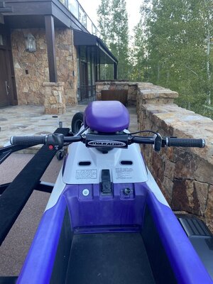

Today was a good day.. We checked all the wiring, replaced all the internals in my s/s/s with the new OEM ones and installed the new bars. Fingers crossed we will be ready for the holiday weekend, I am feeling good about it and the ski is good to go..
I also didn’t realize my handlebars were for kids.. lol The new Riva ones are a lot wider, it will definitely help in the handing department for sure. Really stoked to check them out,
Available here;
I will definitely look into that! Thank you
