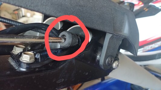

Interesting use of the cable seal grommet.

Thank you for the response..

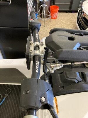

You mentioned interesting use of the cable seal grommet. Educate me if you don’t mind.. what should be happening or not happening?
Are you running a quick turn steering set up? If so which one? Or is this a OVS steering set up? Seeing the bar pad I am guessing ovs?

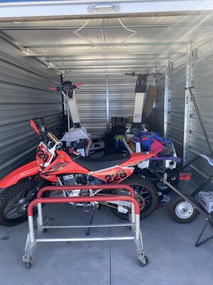

Put the skis in storage, my ski temporarily because of some winter plans….
That’s the wife’s 21/18 CRF 195 dirt scooter in front.. she is a pretty neat machine

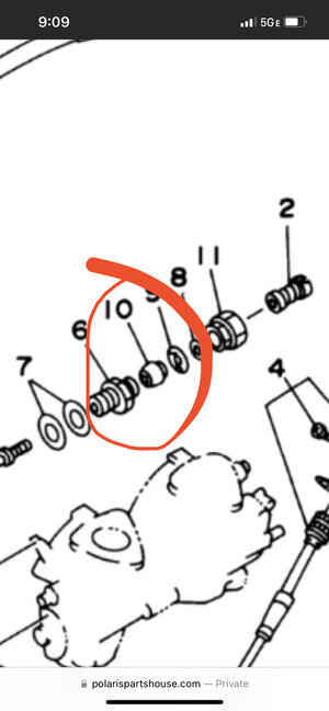

This is where the grommet is supposed to go btw, other end of cable where it goes through ski.

Thank you for the correct information on where the grommet goes.

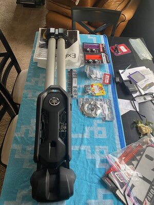

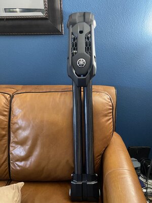

That was with some help.. Ken Wong jet ski photographer is where I got the idea from and a very nice gal from Blowsion (Kayti) made sure I had the cable bracket. I am going to use a Riva HD pole spring, Blowsion billet pole bolt and can’t decide between ODI orange or purple grips. I am going to run the Riva 7/8 bars with a cold fusion quick steer for now and then upgrade to the over the pole set up with fat bars later.

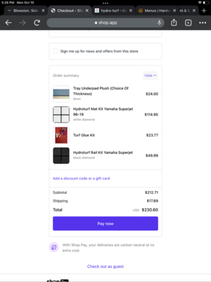

I went with showtime freestyle out of Connecticut, definitely an awesome dude/customer service and was the only place I could find a diamond turf kit and rail kit in black.. Maybe others could find it else where but I am going with him, probably a week til they get here. He is actually cheaper than Hydro-turf fyi..

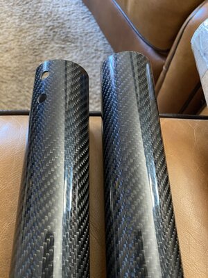

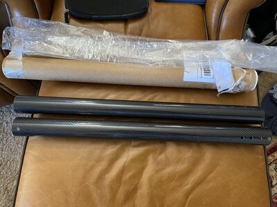

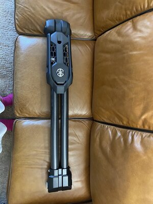

Honestly Macsboost out did him self with his carbon fiber poles.. These poles are beautiful, the weave is amazing, and definitely thicker carbon fiber than I thought. Pretty stoked to throw some Racetech titanium bolts on her to make it even more amazing.

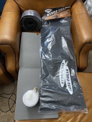

The goods showed up and now the hard work. First time removing turf and installing turf, I feel the rail kit is going to be the most difficult but we will see. I also went another direction, black mat and rail kit instead of purple.
Also shout out to showtime freestyle, great guy to work with and basically same customer service as Jetmaniac.
