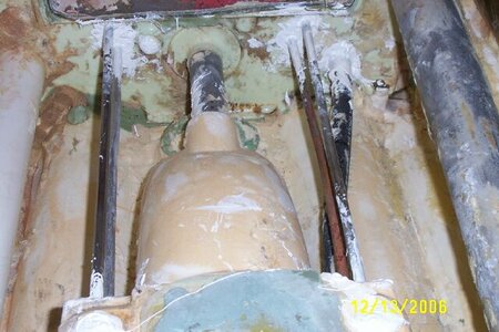

Dry as a bone................. I think it all goes back to how the hull is prepped to begin with... this hull has everything sealed up, the 2 holes that usually have the tape/stickers over them, around all the penetrations, the footholds were totally glassed in........ I was surised, figured I would find some, still have to dig down all the way, but so far no sign of water, trying to deside if I should dig the tray out..................
so, wait.....the foam was dry at the holds? when slutty and I ripped apart my 93 sqaure a couple of years ago the foam at the holds was dry as a bone as well.......
but what about at the bottom of the tray cavity? thats the TRUE test!
Matt_E
steals hub caps from cars
at peace
Exactly. Dry foam at the holds means someone did a good job installing the holds.
