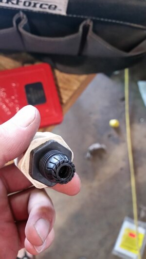

Okay, so I changed what I was going to do about my trim cable. On my way to the hardware store, I remembered that I had a cable gripper and that could make things easier. Not only would it seal the hole, but it would also hold the cable in place.. Tried drilling out the trim plug for it, but I drilled too wide and it ripped the head right off of the threads.
So instead of that, I drilled the cap of a steering cable housing and pressed the cable gripper in. It was a real tight fit so I don't even have to use an adhesive to hold it in which will be nice! However, I still don't 100% trust a cable gripper due to the force that is put on the trim nozzle, so I wanted another securing point. At the hardware store I found a double sided conduit clamp, then cut one side off, drilled and tapped a hole in the nozzle, and then I'm able to secure the cable there too. Stupid simple and will be bulletproof. 20150912_144730.jpg 20150912_144741.jpg

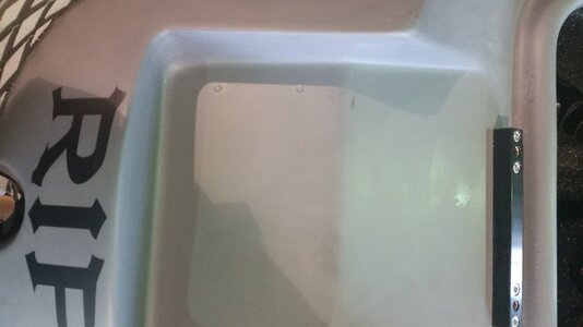

Setting up a pole bracket on this hull is super easy. I don't know about other MFGs, but in Jeff's mold, he leaves indentations where the bracket bolts are so there's no measuring. Just bolt up and go. It was a little stressful drilling into my hull, but all went fine haha.
