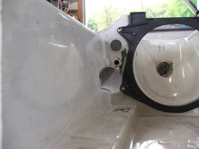

The exhaust side has now been cut, and I've included some shots of the steering relocation hole.
That's gonna be a fun one to glass.
