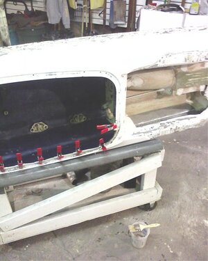

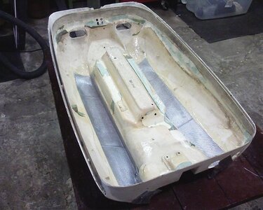

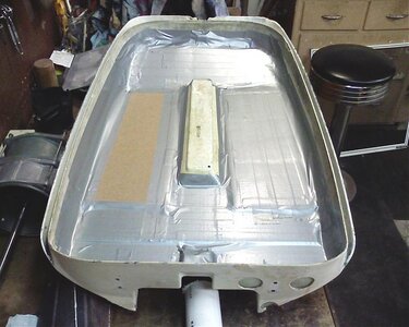

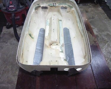

got all the pump and ride plate inserts epoxied back in.
got the inside of the now cut lowered hood all glassed in. 1 layer of 8.5 oz biaxial and 1 layer of 12.5 oz biaxial. I will be using marine filler to fill the outside and sand into shape.
I used cardboard cut to shape and covered that with duct tape, as not to stick. I fastened the duct tape even with the hood so the newly layed glass reinforcement i just did will act as a foundation for the filler.
I may add one more layer of biaxial for added strength.

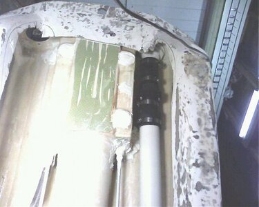

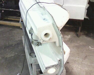

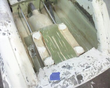

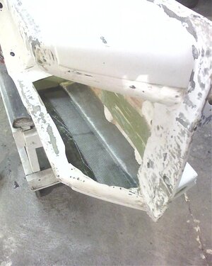

Been a while since i did anything on this...
I finally got back to work on it... reinforced the sides of the tray area (gunwhales) and got all the through hull fittings epoxied in place. Also reinforced the hood seal area...
Going to fabricate my one way valve assembly and will be starting to cut the foam blocks this weekend. and Hopefully install my new WCF side sponsons as well.
I mocked up the tray area real quick just to map out the footholds etc... but it's all just sitting in there until I cut the foam and get it layed in...
Also, the lowered hood project... I will be making a liner for it this weekend as well, and while I am going a different route with an after market hood, I plan to finish lowering this hood for my nephew, who was hit at Daytona and busted up his hood.

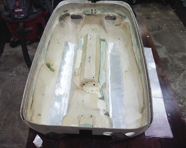

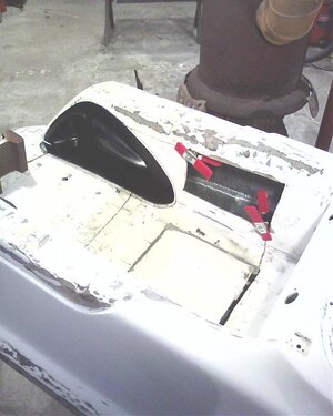

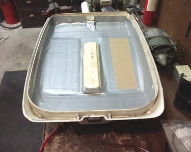

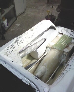

got my one way all set up, and started messing around with trying to cut the foam... not too bad so far...
also got the template ready to make the hood liner for the home made lowered hood project.

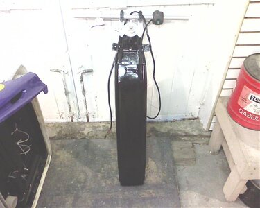

and here is the AC pole - 6" with a short turn plate and straight bars
