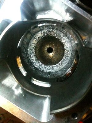

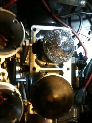

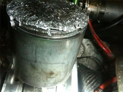

I HAVE SEND A MAIL TO KYLE
I THINK, i have understanD how it is happen....
MY TOTAL LOSS CABLE(masse) WAS NOT CORRECTLY SCREW ON THE CARTER and the spark don t do her job EVERYTIME....
SO THERE IS SO MUCH GAZOLINE BETWEEN THE PISTON AND THE ADA DOME...
THERE IS TOO MUCH PRESSURE....BECAUSE THE GAZOLINE IS NOT BURN!!!
SO THE SEGMENT BROKE AND DESTROY EVERYTHING BETWEEN THE TOP OF THE PISTON AND THE DOME....
what do you think about my theory?
EXCUSE ME FOR MY BAD ENGLISH

ouch looks like a grenade,props to kyle but looks like he is going to be platinum FF here pretty soon with these 16 mill motors out there
id of guessed less than 5% of these guys post on here,but not a knock to dasa builds,its alot of motor sent over seas to guys that may have no clue how to set up the rest of the ign,pump,pipe,cooling,and speaking another language no way to instruct. Thats the price you pay to deal with the mega buck boys out of the country,hence the FF bit
