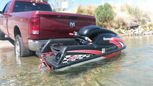

I added a bow stop after owning my hauler for a few years. It's really makes life easier. Faster loading/unloading and I only have one stainless ratchet with quick clips on each end for the rear of the ski.
Some of the stuff said in this thread is rediculous.
I've had straps break on multiple occasions. A bow stop has been the only thing to hold my ski on the hauler. Literally has saved my ski from hitting the ground twice.
The guy who made the hauler I have posted in this thread somewhere. My hauler is fully adjustable all around. And has a REINFORCED piece of 2x2 1/4 wall as the main receiver part. It can accommodate a dirt bike also. It has an adjustable bow stop. And a plate that locks the hitch into the receiver and stops it from moving. The bow stop is probably my favorite part of it vs other haulers.
i tried to find the one with the bow mount but couldnt seem to locate it for the life of me. just pictures that took me back to forums and such but no links. Might end up adding one to mind that is on the way. Anything is better than nothing holding the front outside of the straps.

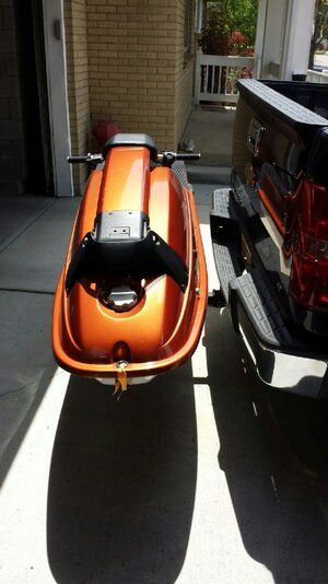

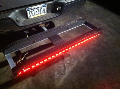

Mine cost $42 in materials for the 2x2 1/4 thick trailer stock and 2 feet of 1/4 angle. I had 3/16 angle iron for the perimeter and trex composite boards lying around for bunks. Took me 2+ hours labor to make it 100% ready for powder coat, first time making one, setting up welder/gas all other tools, drilling holes, grinding smooth edges and all that.
I'm probably gonna finish it after work today!
Would of been cheaper to buy one after time, materials, and powder but whatever, I got to make it myself.
That's a very long stinger on yours. As mentioned. The forces are exponential as you move away from the mounting point. Usually haulers want the ski as close to the hitch as possible. Looks good tbo. Is that a miller 211? I love mine
