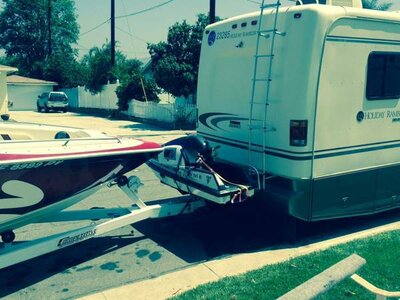

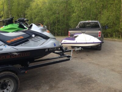

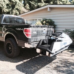

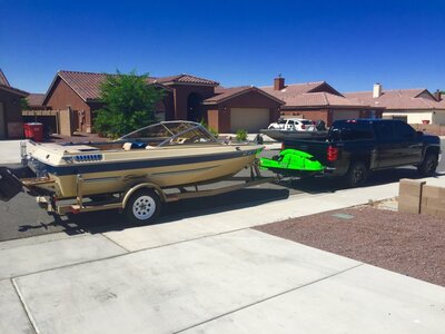

here are a couple shots from customers of the V2 carrier that i make towing behind it .
my carrier will tow 5ooolbs ( but what you need to be concerned with is tongue weight) most class 3 hitches will only support 650lbs of tongue weight .. downward force) the 1st pic is an old version of my carrier00X0X_2PeU913jHUt_600x450.jpg IMG_9335.jpg Tow behind.jpg
