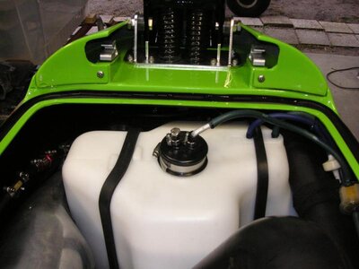

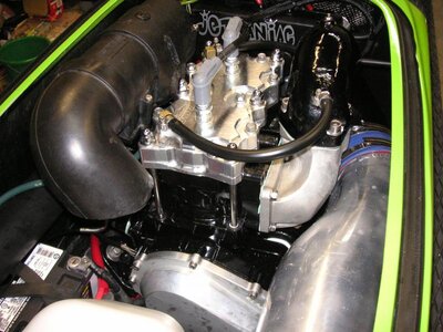

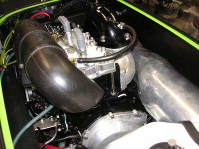

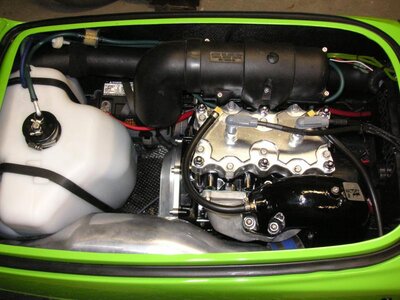

Rode the superfreak again today, the engine should be close to being 'broken-in' I think the impeller is spinning out of the hole and maybe a bit on top. I am going to swap for a taller pitch tomorrow.
Here are some pics of the hood with breather tubes installed and engine installed in the hull.
