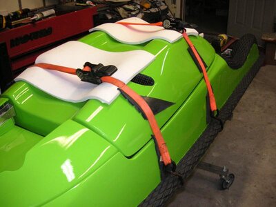

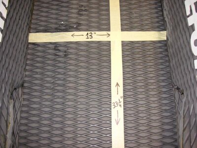

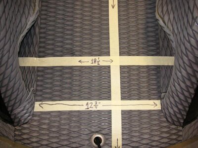

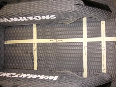

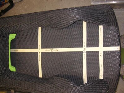

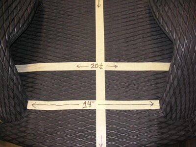

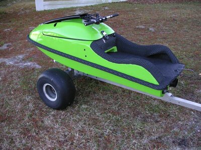

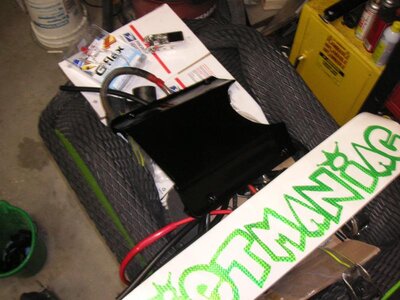

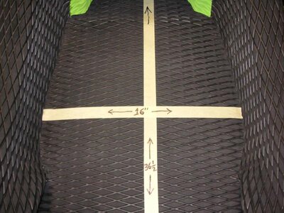

Got some measurements of a stock RN tray with footholds versus the superfreak tray. Crazy large tray!

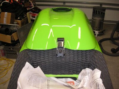

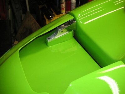

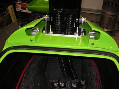

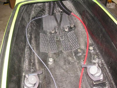

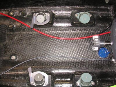

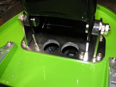

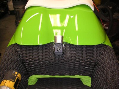

Installed the hood hooks, both xmetal hull and hood side. Then installed the SS xmetal hood latch. Finished the hood install.

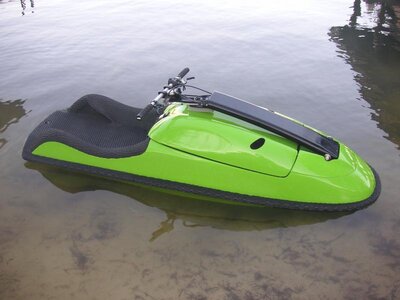

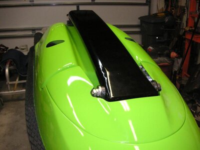

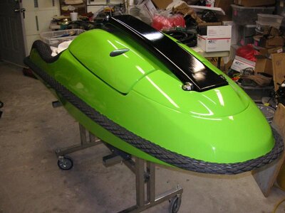

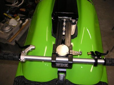

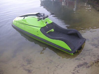

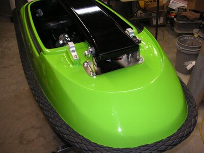

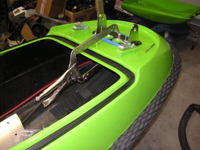

Aligned the xmetal handlepole bracket at the +4" forward position and installed the adjustable xmetal pole system. The nosepiece needed some extra trimming to clearance the pole bolts.

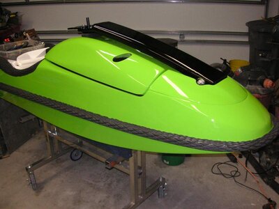

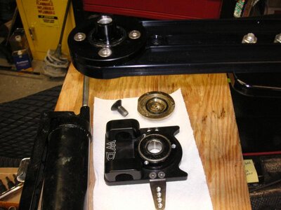

The new xmetal pole comes with the xmetal steering, but I wanted to run the WDK sealed bearing setup instead. I had to drill and tap the new pole for the bearing plate mounting.

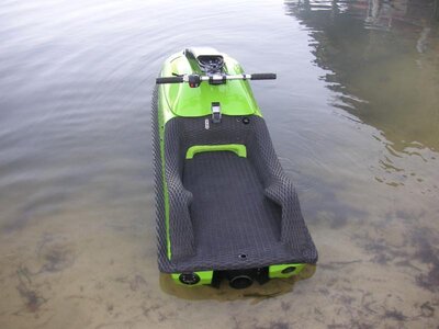

Installed the steering, then mounted the odi rogue grips, sato engineering throttle (thanks surfjunky), thrust trim lever.
