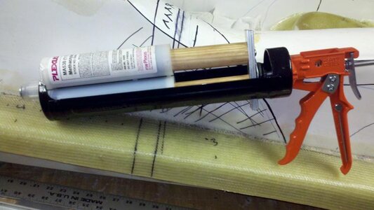

My wife would not let me buy a plexus gun so I had to make my own . This week should be a good one . Material coming in from solar composites . I should get the bulk head in as well as a good start on the top deck mods ...... if I could make up my mind . I keep flip flopping with ideas . Several on the board can attest .

My wife would not let me buy a plexus gun so I had to make my own . This week should be a good one . Material coming in from solar composites so I should get the bulk head in as well as a good start on the top deck mods ...... if I could make up my mind . I keep flip flopping with ideas . several on the board can attest .

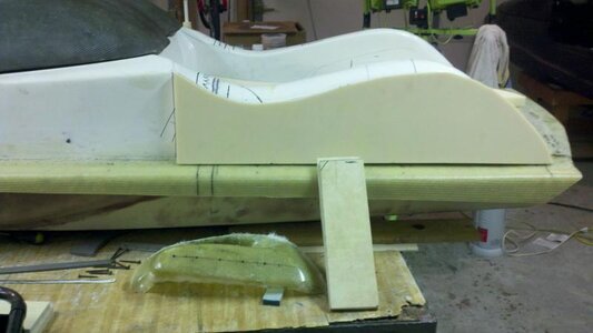

Got a little done tonight . I stopped by spruce aircraft and picked up some last-o-foam . This stuff is pretty expensive ,but I was digging around in the warehouse and found a drop from a 4x8 ... 10 BUCKS ...... SCORE . It forms as easy as the pink stuff the weight is 2 oz more per side , but it is 10 times more structural .
Pic 1 .

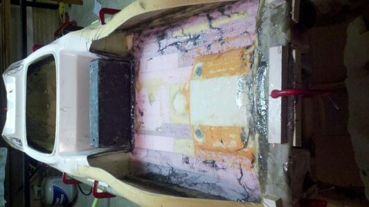

Cut the foam to shape . Also pictured are some blocks that will be inset into the foam to handle the point load for the mounting points of the adjustable foot holds . The smaller blocks are a material called Nylo board. This shi$ is tougher than a two dollar steak , but a little on the heavy side . All total this will add 1.5 pounds per side before glass ..... I might be able to cut that down by 1/2 a pound . I Started out wanting this build to come in under 100 , now I'm really hoping for under 120 hull and hood .
Pic 2 .

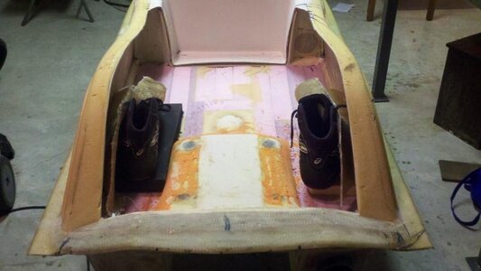

Well it's been a while ...... mounted hard plates for the adjustable foot holds as well as the gunwale extensions than will widen the tray . If I keep fing around Nut is going to throw a top /bottom deck and have the Grunt assembled before I even start the first bolt.

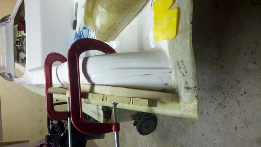

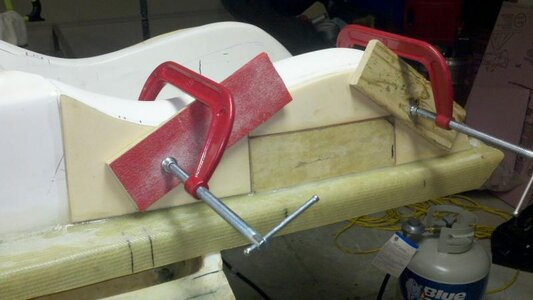

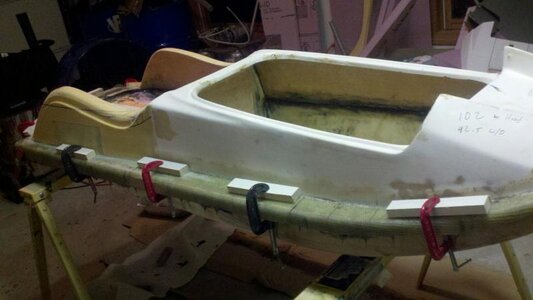

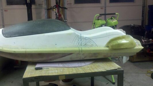

To the build ..... Fear not wee ones I have been working a little every week and tonight I stuck the two halves together ! This was almost an epic composite failure ..... everything sealed up well , but I reeeeally had to work fast and it got sloppy... real sloppy . I figure I cost my self several hours of unnecessary heart ache due to my lack of experance and patients ( reminds me of my junior senior prom back in 85 ) .
I added carbon instead of glass fibers and my mayonnaise consistency got really stringy damn near un spreadable . It worked out , but not exactly how I imagined berry said it would . One thing I have learned about composites is that there are ways people have not yet thought of to F this stuff up....
Pic 1 Clamping (see the clamps)
Pic 2 Adjustable foot hold and lowered tray
The holds are ugly molds not the finished product . I made some out of 4 layers of 19 oz carbon for the finished product . I plan on setting inserts for multiple mounting options . ( see pic 1 ... then on to pic 2 ... and back again to pic 1 . You will see my plan ... my shear brilliance . Don't you see it ? Pic 2.5 ? Look between the pictures grass hopper .... If you ain't been to no ninja school or at least read something about ninjain you won't understand .
Pic 3 Sloppy Clamping ( see more sloppy clamps ) Just call me Jed clam .... I can't

Anyway, things arefinally coming together nicely. Can't you just layer up a ton of underpadding to replace the pink foam? Softest footholds ever!
