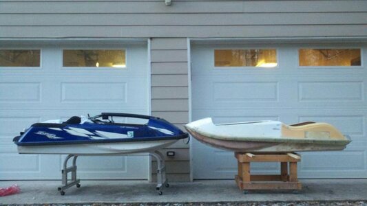

Cleaning up a little this evening, took a pic of a stocker and my hull head to head . I even took the trouble to level them to the same height .

what sort of heater were you using when pull the nose up (not the bond line but the hull)
i'm toying with doing a rocker on a SN, less glass and shaping the hull is far more appealing.
thanks.
Propane space heater and an industrial heat gun . Also used a fluke lazier temp gauge . I think the surface temp was best around 300 degrees F . It would form a little lower just needed more pressure.

Nice Kev. Super curious to see what this thing weighs in at. Its a surf hull so not a big deal, but I am curious.
Love the mods bro.
I'm at 94 lbs with Big ass tubbies and no hood . I estimated the carbon needed to finnish around 108 . Total 114 lbs with hood . I'm guessing it will be about the same weight as stock with foot holds turf etc. It's Real hard managing weight when you cut a hull to pieces and stick it back together .

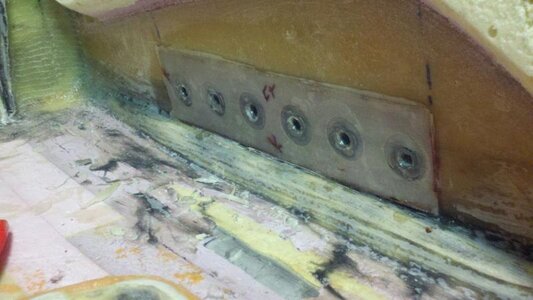

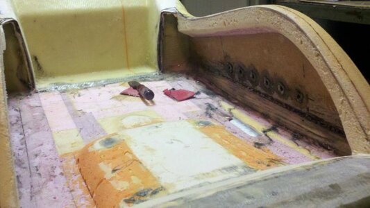

Got the second row of inserts in and the final shaping of the tray done . The bolt spacing will allow adjustment in 2 inch intervals . I would like to have had 1 inch, but the math would not work out . Also Prepped the in side for carbon reenforcement . I'll let the plexus dry then tomorrow plan on starting on some glass .
If you notice the inserts have a slight lip around edge . I plan on laying a layer or two of glass (using it as a shim ) so the foot hold will have a level surface to mount to . I think it will be worth the extra effort.
You could still slot the mounting holes in the foothold 1/2" each. Then each set of inserts would have 1" of adjustability. Genius, says I.
True dat ... That is an option. I had the RRPs in another boat and they would slip if the bolts were not monkey tight. Slotting may be an option , but would probably put a no slip industrial tread ( like skate board grip tape ) on the hold and the gun well to keep it from sliping when you tighten it down.

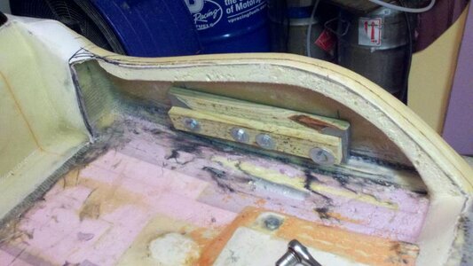

Made the shims and glassed them in . It's going to work great . Used a 1x4 and foot hold bolts to squeeze the shim into place. Came out like I know what I'm doing. It amazes me how much time little things take ..... been working on the freak a little mounting brackets etc. Tomorrow is going to be a marathon glass day . Plan on doing the tray and gunwales .
