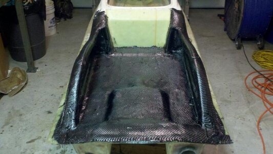

Well ..... I got a sh*& load of sanding and fairing to do , but it went well . I made one small modification . I decided to cut down the width of the gunwale another 1/2 inch to allow for more cushy under pad between my ankle and gunwale. Think Im going to buy an air file ..... added an layer of fairing compound while it was wet just to get a jump on it. Need to do the inside reenforcement tomorrow and I'll be done with the glass work . I think it's going to break 114 lbs we will know this week.

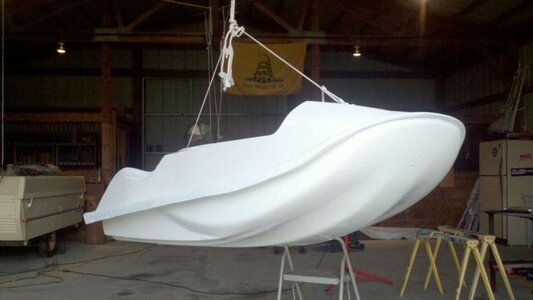

DONE WITH THE GLASS WORK ! Did the rest of the inside reenforcement tonight ..... went like a you tube video ... about time. Did a little fairing as well . Did I mention there is going to be a SH!+ load of sanding and fairing . Hope to prime and paint next week. Going with a high vis yellow despite Mrs. sportfish saying yellow does not look good on me . Function over fashion , I figure for a surf boat brighter is better . Probably using an acrylic enamel for scratch resistance ..... IMO really useless painting a ski in the first place .

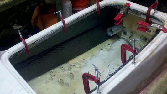

Well all primed up and no place to go . Primed and filled pin holes until I'm not going to fill pin holes any more . It's not perfect but it's all I'm going to do . You can fill sand and prime for a month of Sundays. Big lesson to all you wanna be hull builders. When you prime, use a good epoxy high build surfacing primer. it will save you some labor plus make it easer to hide fairing mistakes. We were going to spray yesterday , but my wife's cousin bailed out on me ....... IN LAWS !
