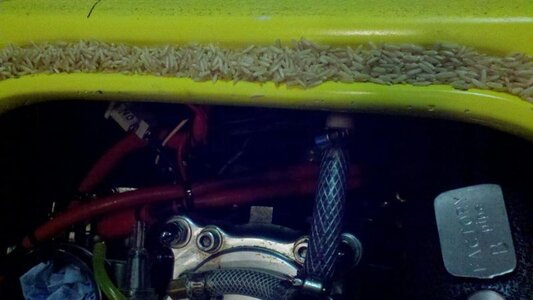

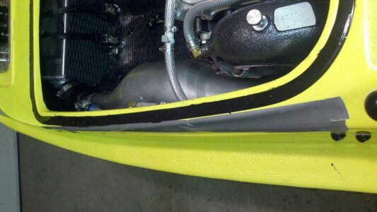

Funny you should mention that .... I'll be running it tomorrow. Made my own hood seal tonight out of two part pure silicone ... I poured the pocket then set the hood down to form an exact fit to the seal. Running without turf or foot holds mounted just to get an idea where I need to be. Bringing the multi master to cut the rails if needed . Here are some pics of the seal. I'll update tomorrow .

Ha ... I knew you morons would not get the rice ..... I used it to calculate the volume of material I would need to fill the void. The silicone hood seal is the wave of the future ..... I Need a few young motivated self starters the income potential could be huge.
