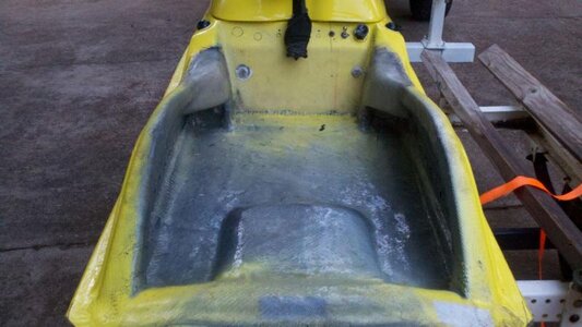

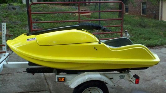

Pic 1 is the tray area (no sh$!) well I made an adjustment so you no goofy types will be at home . The Front foot hold will go from gunwale to gunwale . You whale pockets on each side and the middle .
Pic 2 our our next door neighbors yard jockey (only ramp I could get down ) . The water is still low due to the spillway repairs . O is that the area 51 in the foreground ....... I believe it is .
